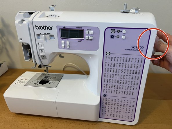

      • Flip the power switch on the back end of the sewing machine to "off."
      • For extra security, also unplug the power cord entirely.

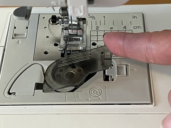

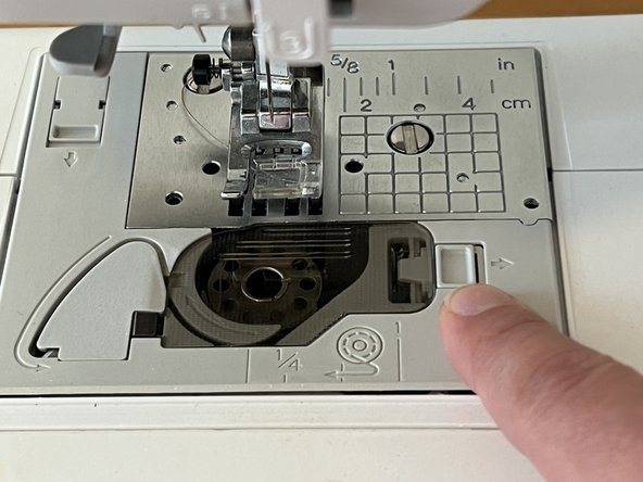

    3. How to Fix a Squeaky Brother SC 9500 Computerized Sewing Machine: step 3, image 1 of 3 How to Fix a Squeaky Brother SC 9500 Computerized Sewing Machine: step 3, image 2 of 3 How to Fix a Squeaky Brother SC 9500 Computerized Sewing Machine: step 3, image 3 of 3
      • Slide the bobbin plate lock switch to the right.
      • The plate cover will pop open.
      • Remove the plate cover.
      • Remove the bobbin (if you have one loaded).

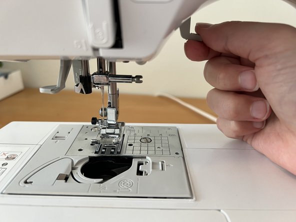

    4. How to Fix a Squeaky Brother SC 9500 Computerized Sewing Machine: step 4, image 1 of 3 How to Fix a Squeaky Brother SC 9500 Computerized Sewing Machine: step 4, image 2 of 3 How to Fix a Squeaky Brother SC 9500 Computerized Sewing Machine: step 4, image 3 of 3

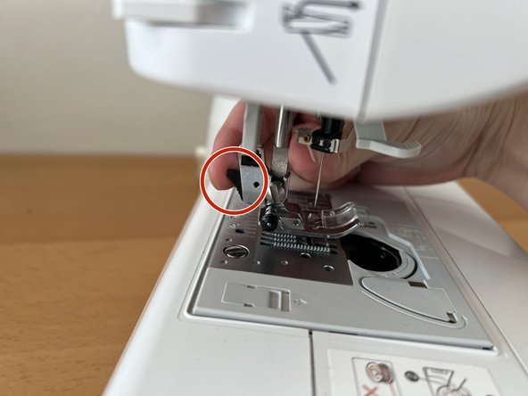

      • Locate the presser foot release switch on the back of the presser foot.
      • Squeeze the release switch gently.
      • The pressure foot will drop away. Set it aside for later.

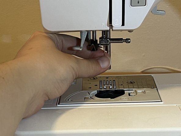

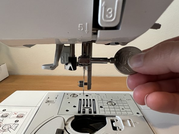

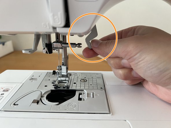

    5. How to Fix a Squeaky Brother SC 9500 Computerized Sewing Machine: step 5, image 1 of 2 How to Fix a Squeaky Brother SC 9500 Computerized Sewing Machine: step 5, image 2 of 2

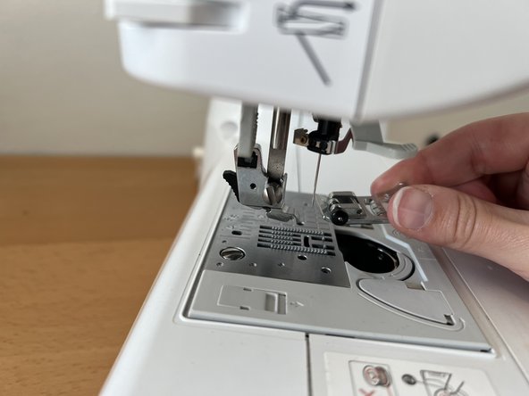

      • Use a coin to twist the needle securing screw towards yourself (counterclockwise).
      • The needle will drop down when it's loose enough. Carefully set the needle aside.

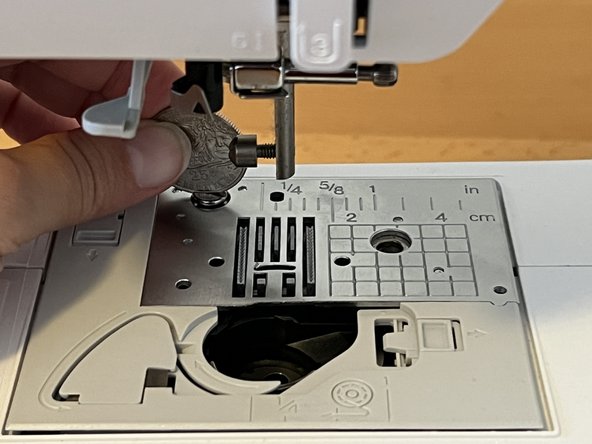

    6. How to Fix a Squeaky Brother SC 9500 Computerized Sewing Machine: step 6, image 1 of 3 How to Fix a Squeaky Brother SC 9500 Computerized Sewing Machine: step 6, image 2 of 3 How to Fix a Squeaky Brother SC 9500 Computerized Sewing Machine: step 6, image 3 of 3
      • Use a coin to unscrew the two screws holding the bobbin well cover plate in place.
      • The first screw is located in the middle of the grid lines on the metal plate. The second screw is located in the top right corner of the metal plate.
      • Lift the well cover plate from the left edge first to remove it.

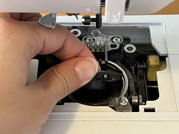

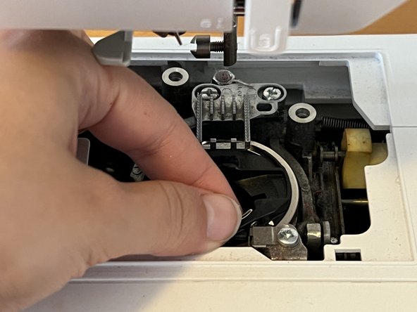

      • Pinch the black bobbin well and lift it up and away from the bobbin well tray to remove it.
      • Do not rotate the bobbin well when you remove it (maintain the same orientation). This makes it easier to replace the well at the end.

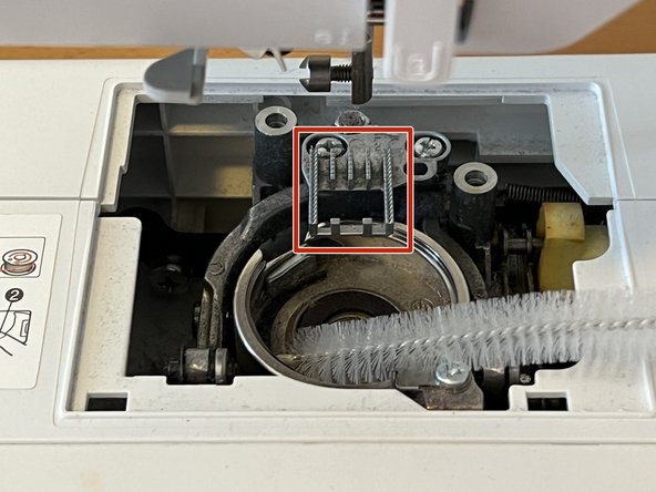

    8. How to Fix a Squeaky Brother SC 9500 Computerized Sewing Machine: step 8, image 1 of 2 How to Fix a Squeaky Brother SC 9500 Computerized Sewing Machine: step 8, image 2 of 2
      • Use a straw cleaner to remove dust and lint from the bobbin well tray.
      • You should also use the straw cleaner to clean between the metal teeth on the feed dogs.

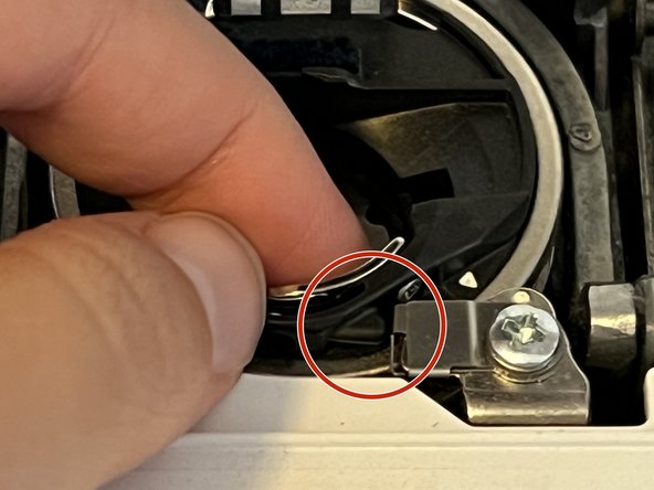

    9. How to Fix a Squeaky Brother SC 9500 Computerized Sewing Machine: step 9, image 1 of 2 How to Fix a Squeaky Brother SC 9500 Computerized Sewing Machine: step 9, image 2 of 2
      • Replace the bobbin well once all the dust is gone.
      • Make sure the black tab on the black bobbin well is placed right up against the metal spring in the bobbin well tray.
      • If it's not aligned properly, your machine will not work. When you twist the black bobbin well counterclockwise, the plastic tab should depress the metal spring.

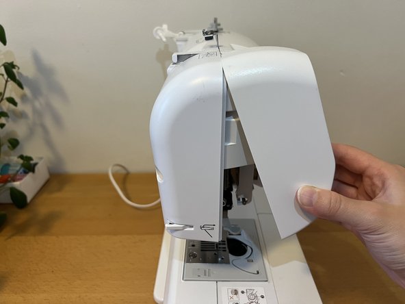

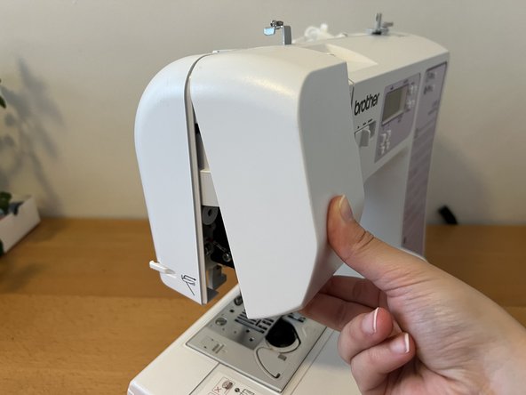

    11. How to Fix a Squeaky Brother SC 9500 Computerized Sewing Machine: step 11, image 1 of 3 How to Fix a Squeaky Brother SC 9500 Computerized Sewing Machine: step 11, image 2 of 3 How to Fix a Squeaky Brother SC 9500 Computerized Sewing Machine: step 11, image 3 of 3
      • Turn the machine around to the back and unscrew the single screw on the far right edge.
      • The faceplate screw is set about an inch into the plastic body of the machine.
      • Pinch the bottom edge of the faceplate and pull up to detach.

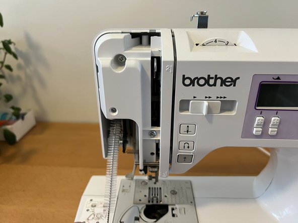

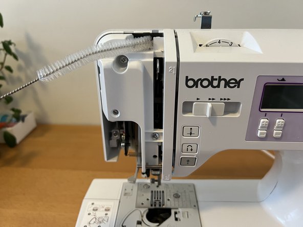

    12. How to Fix a Squeaky Brother SC 9500 Computerized Sewing Machine: step 12, image 1 of 3 How to Fix a Squeaky Brother SC 9500 Computerized Sewing Machine: step 12, image 2 of 3 How to Fix a Squeaky Brother SC 9500 Computerized Sewing Machine: step 12, image 3 of 3
      • Use the straw cleaner to dust the top, bottom left, and inner right sides of the internal needle arm mechanism.

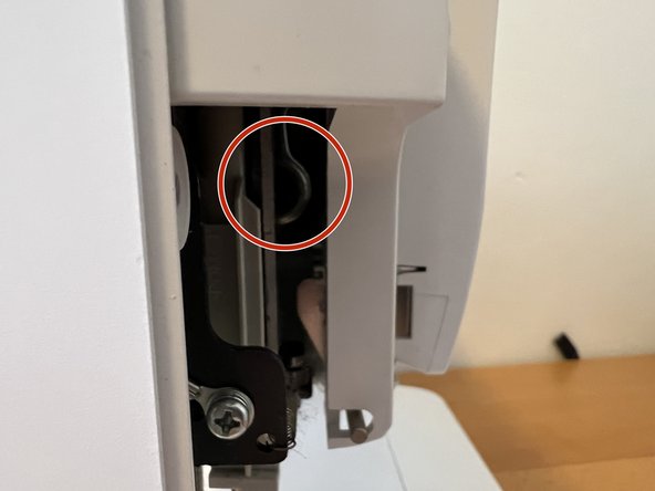

    13. How to Fix a Squeaky Brother SC 9500 Computerized Sewing Machine: step 13, image 1 of 3 How to Fix a Squeaky Brother SC 9500 Computerized Sewing Machine: step 13, image 2 of 3 How to Fix a Squeaky Brother SC 9500 Computerized Sewing Machine: step 13, image 3 of 3
      • Locate the inner joint. It looks like a large round disk in the right side of the needle arm mechanism.
      • A flashlight is helpful to locate the joint.
      • Apply two drops of sewing machine oil to this joint.
      Ask FixBot
    14. How to Fix a Squeaky Brother SC 9500 Computerized Sewing Machine: step 14, image 1 of 1
      • Turn the hand wheel on the end of your machine two full times clockwise to spread the oil around the joint.

    15. How to Fix a Squeaky Brother SC 9500 Computerized Sewing Machine: step 15, image 1 of 2 How to Fix a Squeaky Brother SC 9500 Computerized Sewing Machine: step 15, image 2 of 2
      • Replace the faceplate.
      • Slot the top edge over the exposed inner mechanism first.
      • Lower the faceplate cover until it snaps into place at the bottom.
      • Replace the screw of the back of the machine until it is hand-tight.

    17. How to Fix a Squeaky Brother SC 9500 Computerized Sewing Machine: step 17, image 1 of 2 How to Fix a Squeaky Brother SC 9500 Computerized Sewing Machine: step 17, image 2 of 2

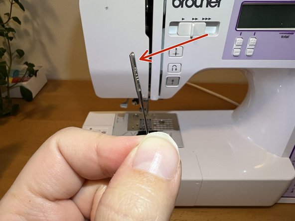

      • Lastly, carefully replace the needle.
      • Sewing machine needles have a round front and a flat back. Insert the needle with the flat back facing away from you.
      • Use a coin to tighten the needle screw clockwise until it is hand-tight.
