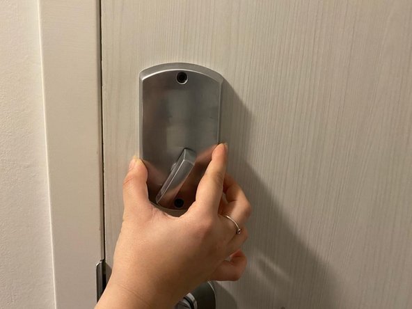

  1. How to Fix a Schlage Door Lock, Battery: step 1, image 1 of 3 How to Fix a Schlage Door Lock, Battery: step 1, image 2 of 3 How to Fix a Schlage Door Lock, Battery: step 1, image 3 of 3
    • Remove the two 3 mm Phillips #1 screws from the battery cover.
  2. How to Fix a Schlage Door Lock: step 2, image 1 of 2 How to Fix a Schlage Door Lock: step 2, image 2 of 2
    • Remove the battery cover slowly.
  3. How to Fix a Schlage Door Lock: step 3, image 1 of 2 How to Fix a Schlage Door Lock: step 3, image 2 of 2
    • Remove the batteries one by one from the interior assembly.
  4. How to Fix a Schlage Door Lock: step 4, image 1 of 2 How to Fix a Schlage Door Lock: step 4, image 2 of 2
    • Install four AA batteries in the battery pack.
  5. How to Fix a Schlage Door Lock: step 5, image 1 of 2 How to Fix a Schlage Door Lock: step 5, image 2 of 2
    • Reinstall the battery cover.
  6. How to Fix a Schlage Door Lock: step 6, image 1 of 1
    • Use the Phillips #1 screwdriver to tighten the screws.
