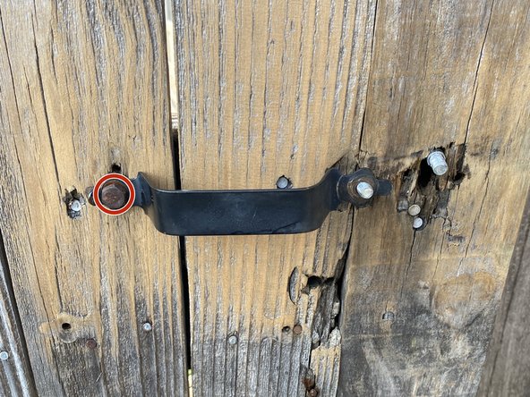

    • Remove all screws and bolts holding your gate latch down.
    • I utilized a Phillips #2 screwdriver and 1/2 in. wrench to complete this task, however your individual gate latch may require other specified sized tools.

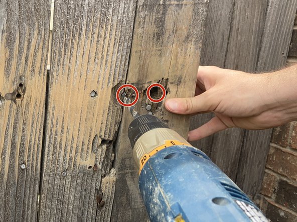

  4. How to Fix a Loose Gate Latch on a Wooden Gate: step 4, image 1 of 2 How to Fix a Loose Gate Latch on a Wooden Gate: step 4, image 2 of 2
    • Use an electric drill and and a 3/8 inch carbide drill bit to create the 3/8 in. pilot holes for the anchors that will be installed.

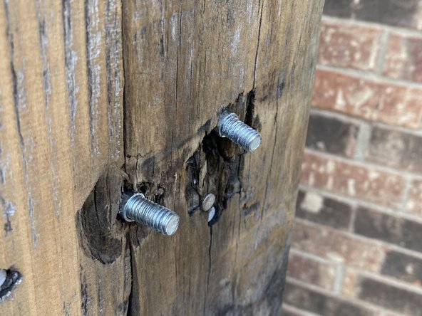

  5. How to Fix a Loose Gate Latch on a Wooden Gate: step 5, image 1 of 3 How to Fix a Loose Gate Latch on a Wooden Gate: step 5, image 2 of 3 How to Fix a Loose Gate Latch on a Wooden Gate: step 5, image 3 of 3
    • Using a hammer, tap in the sleeve anchors with the washer and bolt still attached, to prevent the sleeve and anchor bolt from separating.
    • Keep tapping the sleeve anchor until most of the sleeve is seated in the wood while leaving 12.7 mm of thread protruding from the wood.
    • This will allow you to be able to reinstall the gate latch.
    • Remove the bolts and washers from Sleeve Anchors once they have been inserted into the piloted holes.
  6. How to Fix a Loose Gate Latch on a Wooden Gate: step 6, image 1 of 3 How to Fix a Loose Gate Latch on a Wooden Gate: step 6, image 2 of 3 How to Fix a Loose Gate Latch on a Wooden Gate: step 6, image 3 of 3
    • Reposition the gate handle and the gate latch.
    • Use a a 1/2 inch wrench to fasten the salvaged hardware onto the gate latch.
    • Reattach the gate latch and handle with the new hardware from the sleeve anchors with a 1/2 inch wrench.
