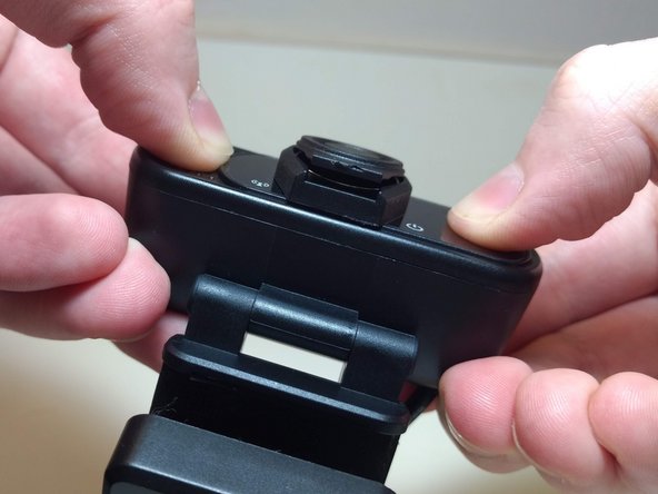

How to Fix a Loose Connector in an Anivia 1080p Webcam
  1. How to Fix a Loose Connector in an Anivia 1080p Webcam, How to Fix a Loose Connector in an Anivia 1080p Webcam: step 1, image 1 of 3 How to Fix a Loose Connector in an Anivia 1080p Webcam, How to Fix a Loose Connector in an Anivia 1080p Webcam: step 1, image 2 of 3 How to Fix a Loose Connector in an Anivia 1080p Webcam, How to Fix a Loose Connector in an Anivia 1080p Webcam: step 1, image 3 of 3

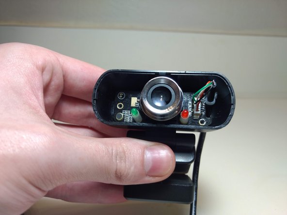

    • Pry open the face plate of the webcam using the iFixit opening pick or another safe tool, and set it aside.
  2. How to Fix a Loose Connector in an Anivia 1080p Webcam: step 2, image 1 of 3 How to Fix a Loose Connector in an Anivia 1080p Webcam: step 2, image 2 of 3 How to Fix a Loose Connector in an Anivia 1080p Webcam: step 2, image 3 of 3

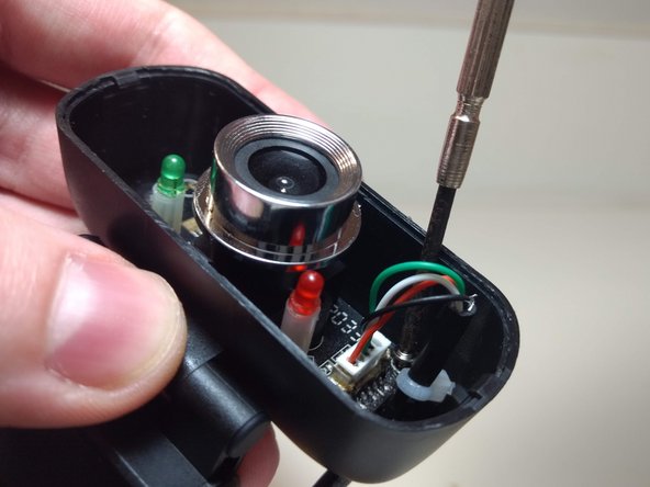

    • Remove the three main screws using a Phillips screwdriver while carefully holding the camera motherboard in place.
  3. How to Fix a Loose Connector in an Anivia 1080p Webcam: step 3, image 1 of 3 How to Fix a Loose Connector in an Anivia 1080p Webcam: step 3, image 2 of 3 How to Fix a Loose Connector in an Anivia 1080p Webcam: step 3, image 3 of 3

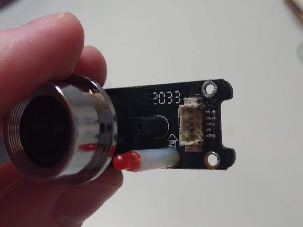

    • Remove the camera and motherboard from the casing carefully.
  4. How to Fix a Loose Connector in an Anivia 1080p Webcam: step 4, image 1 of 3 How to Fix a Loose Connector in an Anivia 1080p Webcam: step 4, image 2 of 3 How to Fix a Loose Connector in an Anivia 1080p Webcam: step 4, image 3 of 3

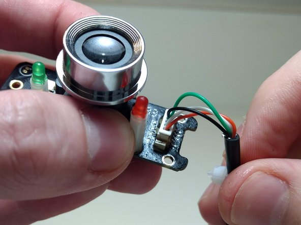

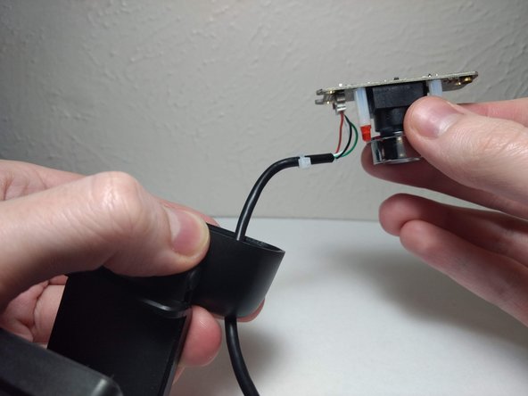

    • Detach the cable from the connecter on the motherboard.
    • Pull from the plastic as to not damage any of the wires.
  5. How to Fix a Loose Connector in an Anivia 1080p Webcam: step 5, image 1 of 3 How to Fix a Loose Connector in an Anivia 1080p Webcam: step 5, image 2 of 3 How to Fix a Loose Connector in an Anivia 1080p Webcam: step 5, image 3 of 3

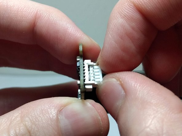

    • Identify where the connector is loose and solder the piece back into place.
    • Use only as little solder as needed to keep functionality in tact.
    • Caution: The soldering iron is hot and should be handled with care.
  6. How to Fix a Loose Connector in an Anivia 1080p Webcam: step 6, image 1 of 2 How to Fix a Loose Connector in an Anivia 1080p Webcam: step 6, image 2 of 2
    • Reattach the cable to the connector.
  7. How to Fix a Loose Connector in an Anivia 1080p Webcam: step 7, image 1 of 2 How to Fix a Loose Connector in an Anivia 1080p Webcam: step 7, image 2 of 2
    • Place the motherboard and camera back into the casing.
  8. How to Fix a Loose Connector in an Anivia 1080p Webcam: step 8, image 1 of 3 How to Fix a Loose Connector in an Anivia 1080p Webcam: step 8, image 2 of 3 How to Fix a Loose Connector in an Anivia 1080p Webcam: step 8, image 3 of 3
    • Screw the camera and motherboard back into place.
  9. How to Fix a Loose Connector in an Anivia 1080p Webcam: step 9, image 1 of 3 How to Fix a Loose Connector in an Anivia 1080p Webcam: step 9, image 2 of 3 How to Fix a Loose Connector in an Anivia 1080p Webcam: step 9, image 3 of 3
    • Snap the faceplate covering back into place.
