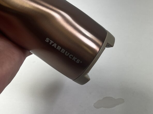

  1. How to Fix a Leak on a Twisted Thermal Mug from Starbucks, Silicone Gasket: step 1, image 1 of 3 How to Fix a Leak on a Twisted Thermal Mug from Starbucks, Silicone Gasket: step 1, image 2 of 3 How to Fix a Leak on a Twisted Thermal Mug from Starbucks, Silicone Gasket: step 1, image 3 of 3
    • Fill the bottle with water and secure the lid.
    • Tilt, shake, or turn it upside down to pinpoint the source of the leak—whether it’s from the lid, spout, or base.

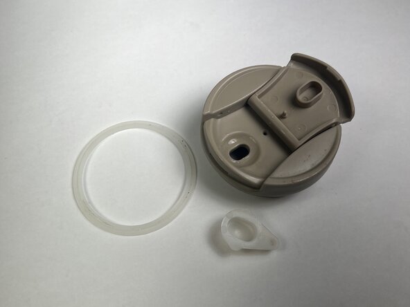

  2. How to Fix a Leak on a Twisted Thermal Mug from Starbucks: step 2, image 1 of 2 How to Fix a Leak on a Twisted Thermal Mug from Starbucks: step 2, image 2 of 2
    • Open the bottle and examine the rubber gasket or O-ring inside the lid.
    • Look for cracks, deformation, brittleness, or signs of wear.

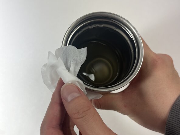

  3. How to Fix a Leak on a Twisted Thermal Mug from Starbucks: step 3, image 1 of 2 How to Fix a Leak on a Twisted Thermal Mug from Starbucks: step 3, image 2 of 2
    • Take apart all removable components—cap, straw, inner seals.
    • Ensure everything is cleaned and inspected.

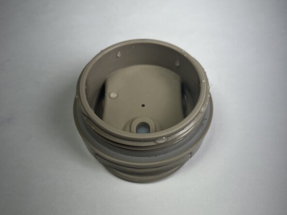

  4. How to Fix a Leak on a Twisted Thermal Mug from Starbucks: step 4, image 1 of 1
    • Measure the rubber part’s inner and outer diameter, and its thickness.
    • This helps in finding the correct replacement.

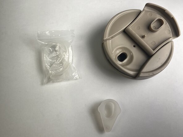

  5. How to Fix a Leak on a Twisted Thermal Mug from Starbucks: step 5, image 1 of 3 How to Fix a Leak on a Twisted Thermal Mug from Starbucks: step 5, image 2 of 3 How to Fix a Leak on a Twisted Thermal Mug from Starbucks: step 5, image 3 of 3
    • Carefully insert the new O-ring, ensuring it fits snugly into its groove.
    • Avoid overstretching or misaligning the new seal.

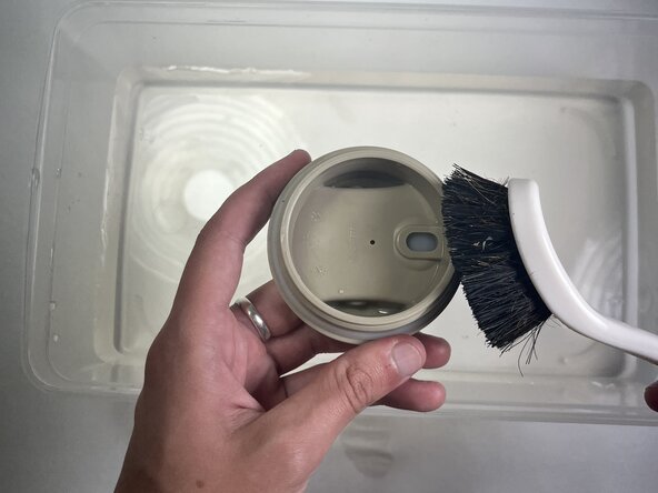

  6. How to Fix a Leak on a Twisted Thermal Mug from Starbucks: step 6, image 1 of 3 How to Fix a Leak on a Twisted Thermal Mug from Starbucks: step 6, image 2 of 3 How to Fix a Leak on a Twisted Thermal Mug from Starbucks: step 6, image 3 of 3
    • Wash all components with mild soap and warm water.
    • Use a soft brush or cotton swab to clean hard-to-reach areas.
    • Rinse and let everything dry completely.

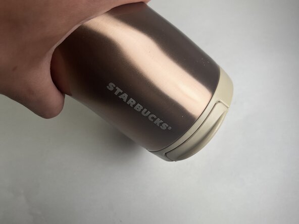

  7. How to Fix a Leak on a Twisted Thermal Mug from Starbucks: step 7, image 1 of 1
    • Put the bottle back together and fill it again to test.
    • Shake or turn it upside down to confirm the seal is holding and the leak is gone.
