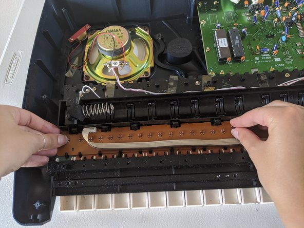

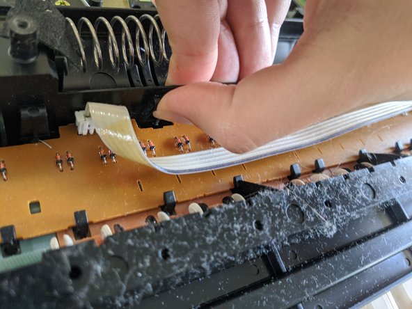

  4. How to Fix a Dead Key on a Yamaha PSR-280 Piano Keyboard: step 4, image 1 of 3 How to Fix a Dead Key on a Yamaha PSR-280 Piano Keyboard: step 4, image 2 of 3 How to Fix a Dead Key on a Yamaha PSR-280 Piano Keyboard: step 4, image 3 of 3
    • At the top of the contact pad, carefully pinch the black clamps closed.
    • Once all the clamps are closed, wiggle the contact pad free.
    • Be careful of the small black hooks at the bottom.
  5. How to Fix a Dead Key on a Yamaha PSR-280 Piano Keyboard: step 5, image 1 of 1
    • After the contact pad is free, gently lift it up.

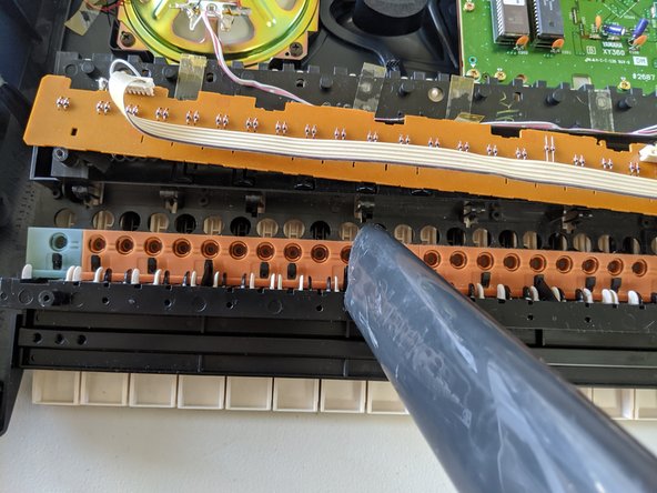

  6. How to Fix a Dead Key on a Yamaha PSR-280 Piano Keyboard: step 6, image 1 of 3 How to Fix a Dead Key on a Yamaha PSR-280 Piano Keyboard: step 6, image 2 of 3 How to Fix a Dead Key on a Yamaha PSR-280 Piano Keyboard: step 6, image 3 of 3
    • Vacuum and/or gently wipe the dust away.
  7. How to Fix a Dead Key on a Yamaha PSR-280 Piano Keyboard: step 7, image 1 of 1
    • Place the contact pad back gently.

This is a good pictorial guide to how the keyboard works and how to service it, I used electronic switch cleaner {aerosol} on a cloth to clean the contacts and it was successful leaving all the keys working.
