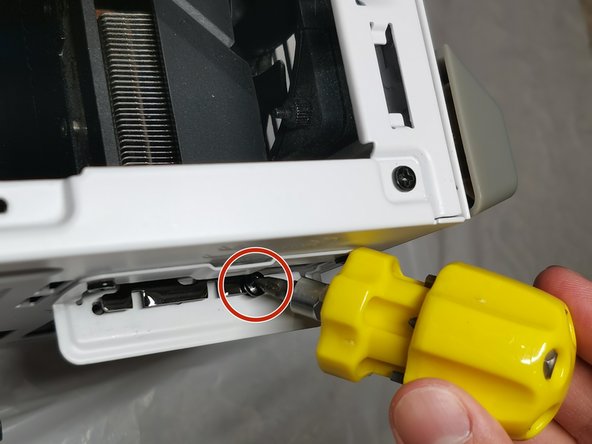

    • Using a screwdriver or potentially just your hands, remove the panel from the PC case. You might have to remove screws but cases vary.
    • If your case happens to have screws on the back panel, simply remove them, but do remember to correctly distribute all the screws in a cleared area so that you don’t lose any of them while performing additional steps later.

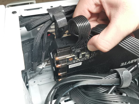

    • Once the back panel of your PC case is opened, disconnect the graphics card from both the monitor and the motherboard.
    • Take a picture of how the wires are connected so that you don’t mess up when you try to put it back later.
    • Be gentle and careful working with connection wires. Connection wires are easy to find but are usually loose and vulnerable.

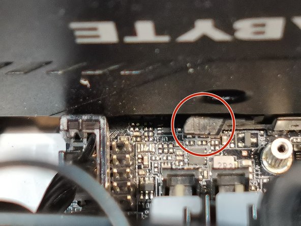

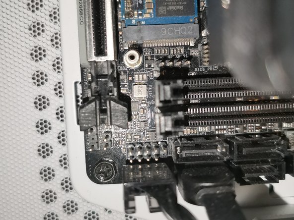

    • Notice the little black clip on the motherboard next to the graphics card. That is the release key.
    • If the clip is a bit too deep to reach, find a stick and press it down so that you can pull up your graphics card with no stress.
    • Pull out the graphics card and lay it down on a flat surface.

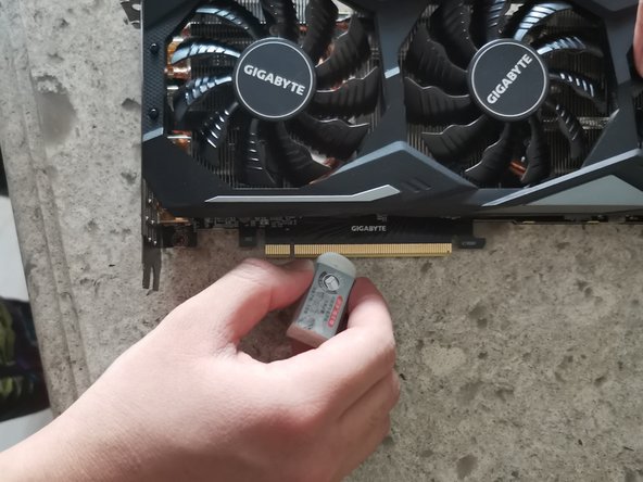

    • The gold spike edge is usually identified as the connecting finger of many electronic parts.
    • Softly clean the connecting finger with a rubber. Remember to rub both sides of the connecting finger.

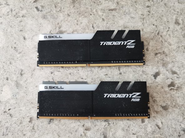

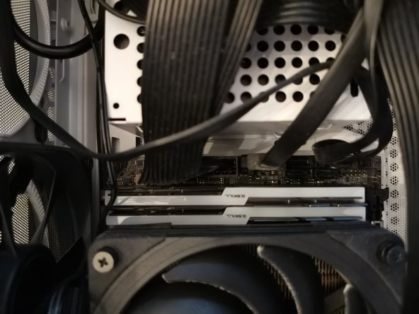

    • Take out the RAM sticks. These RAM sticks are fixed and attached to the RAM slots on the motherboard. They can be easily damaged if you attempt to pull them out straight.
    • Loosen the clips on both sides of the RAM slot first and then unplug the RAM. It should be fairly easy once you unclip the slot.
  8. How to Fix a Connection Problem With A Gaming Monitor and Desktop Computer: step 8, image 1 of 2 How to Fix a Connection Problem With A Gaming Monitor and Desktop Computer: step 8, image 2 of 2
    • Use the rubber to clean the connecting finger of the RAM.
