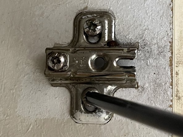

    • Choose the correct screwdriver to remove the damaged hinge.
    • A properly sized bit should “fill up” the screw head, utilizing both the full depth and width of the socket.
    • In general, use the largest bit size that fits snugly into the screw.

    • If the door is still attach to the cabinet, use your screwdriver to remove the screws from the door hinges.
    • Take the doors off the cabinets before you begin the repair.

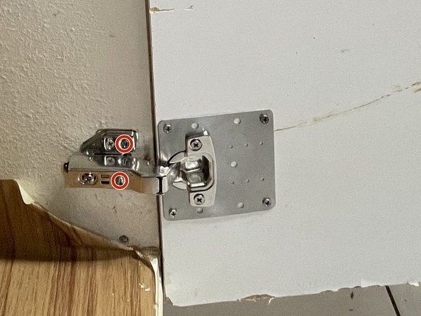

    • Remove all of the screws from the first hinge of the cabinet.
  4. How to Fix a Cabinet Door Hinge with a Damaged Base: step 4, image 1 of 3 How to Fix a Cabinet Door Hinge with a Damaged Base: step 4, image 2 of 3 How to Fix a Cabinet Door Hinge with a Damaged Base: step 4, image 3 of 3
    • Remove all the the screws from the second hinge of the cabinet.
  5. How to Fix a Cabinet Door Hinge with a Damaged Base: step 5, image 1 of 3 How to Fix a Cabinet Door Hinge with a Damaged Base: step 5, image 2 of 3 How to Fix a Cabinet Door Hinge with a Damaged Base: step 5, image 3 of 3
    • Remove all of the screws from the door hinge.

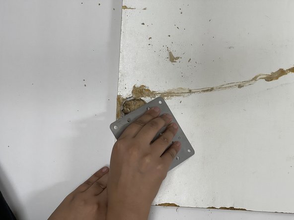

    • Squeeze the wood filler in the damaged base of the cabinet.
    • Some wood fillers require you to mix them with hardener. For those types, add 1/3 amount of hardener with filler and mix them until a consistent texture. Then apply the mixture to the damaged area. For more clarity, watch this video.
    • Place a card beside the hole and fill the hole with wood filler.
    • Overfill the damaged base slightly, to ensure the hole is filled completely.
  7. How to Fix a Cabinet Door Hinge with a Damaged Base: step 7, image 1 of 3 How to Fix a Cabinet Door Hinge with a Damaged Base: step 7, image 2 of 3 How to Fix a Cabinet Door Hinge with a Damaged Base: step 7, image 3 of 3
    • Scrape the extra filler from the base with a putty knife or stiff card to smooth the surface before it dries.
    • Leave the filler for 20 to 30 minutes to dry.

    • Place the cabinet hinge repair plate on the new base and secure with the screws that are included in the kit.
    • Make sure the plate is properly aligned with existing holes.
