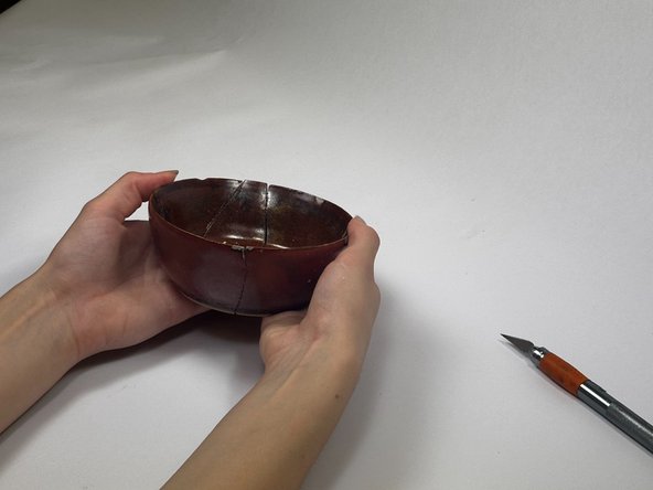

    • Clean the broken ceramic with rubbing alcohol.

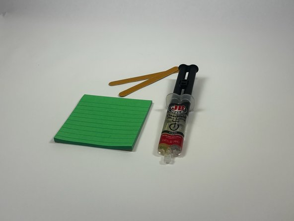

    • Mix epoxy to paste the pieces of ceramics together.
    • If you are using Epoxy that is not pre-mixed, combine the two-part Epoxy using a paper pad and wooden stick.

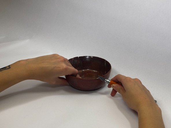

    • Apply Epoxy to the edges and place the broken ceramic pieces in their permanent location.
    • Press the broken pieces firmly together.
    • Epoxy will ooze out. Do not wipe off to avoid smearing.
    • Use the container of sand to help hold pieces in place.

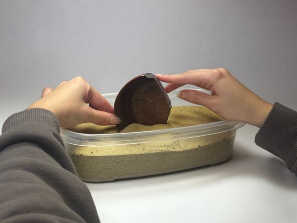

    • Use clay for securing the attached pieces during the curing process.

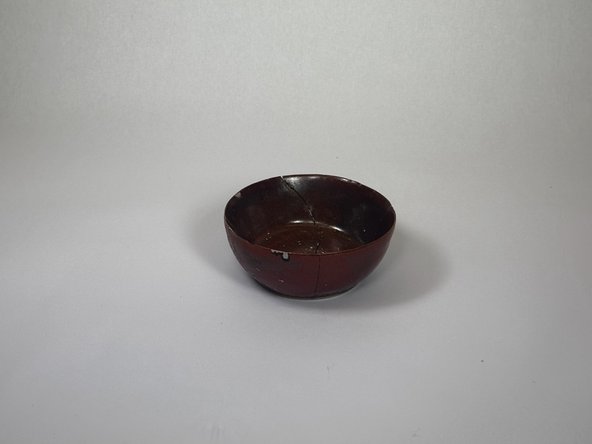

    • Use the Exacto knife to remove the excess dried Epoxy from the bowl.
    • Be cautious while handling the tool. The blade is very sharp.
  6. How to Fix a Broken Decorative Ceramic Bowl: step 6, image 1 of 2 How to Fix a Broken Decorative Ceramic Bowl: step 6, image 2 of 2
    • Check if the pieces are secure.
    • Let the bowl set for an hour before use.
