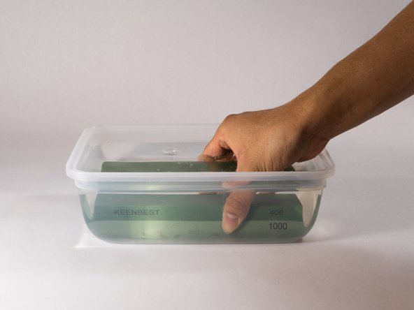

  1. How to Fix a Broken Chef’s Knife Tip, How to Fix a Broken Chef’s Knife Tip: step 1, image 1 of 3 How to Fix a Broken Chef’s Knife Tip, How to Fix a Broken Chef’s Knife Tip: step 1, image 2 of 3 How to Fix a Broken Chef’s Knife Tip, How to Fix a Broken Chef’s Knife Tip: step 1, image 3 of 3
    • Submerge the whetstone in a container of water for 15 minutes or as directed by the manufacturer.

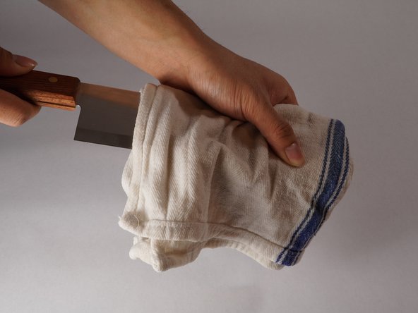

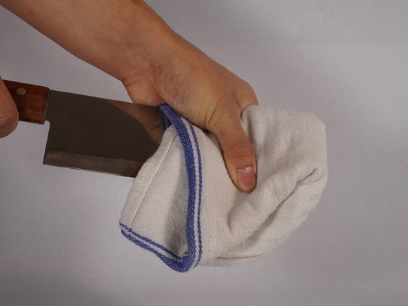

  2. How to Fix a Broken Chef’s Knife Tip: step 2, image 1 of 3 How to Fix a Broken Chef’s Knife Tip: step 2, image 2 of 3 How to Fix a Broken Chef’s Knife Tip: step 2, image 3 of 3
    • Align your palm with the back of the blade (the blunt side), and wipe down the blade with a towel.
    • Avoid touching the sharp edge of the knife with your fingers at all times.

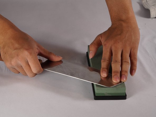

  5. How to Fix a Broken Chef’s Knife Tip: step 5, image 1 of 2 How to Fix a Broken Chef’s Knife Tip: step 5, image 2 of 2
    • Rinse the blade in water and wipe off excess water periodically to remove metal shavings.

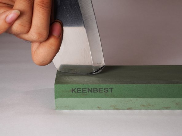

  6. How to Fix a Broken Chef’s Knife Tip: step 6, image 1 of 3 How to Fix a Broken Chef’s Knife Tip: step 6, image 2 of 3 How to Fix a Broken Chef’s Knife Tip: step 6, image 3 of 3
    • Once you have shaved down the top of the blade, adjust the blade's position so only the tip is touching the whetstone.
    • Shave down the tip of the blade and adjust the position of the blade frequently to follow the curve of the sharpie line.
    • After reaching the sharpie line, flip the stone to the 1000 grit side and repeat steps 1 and 2 until the surface is smooth.
