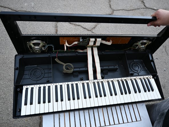

    • Test all keys to identify the ones that are not functional.
  2. How to Fix Unresponsive Keys for an Optimus Concertmate 980: step 2, image 1 of 3 How to Fix Unresponsive Keys for an Optimus Concertmate 980: step 2, image 2 of 3 How to Fix Unresponsive Keys for an Optimus Concertmate 980: step 2, image 3 of 3
    • Flip the piano to its backside.
    • Remove all the screws on the back of the piano using a Phillips #0 screwdriver.
  3. How to Fix Unresponsive Keys for an Optimus Concertmate 980: step 3, image 1 of 3 How to Fix Unresponsive Keys for an Optimus Concertmate 980: step 3, image 2 of 3 How to Fix Unresponsive Keys for an Optimus Concertmate 980: step 3, image 3 of 3
    • Remove the back metal plate.
    • Flip the piano to its front before the next step.

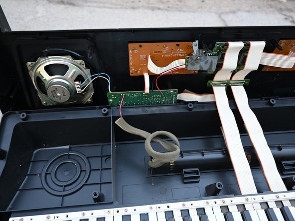

  4. How to Fix Unresponsive Keys for an Optimus Concertmate 980: step 4, image 1 of 2 How to Fix Unresponsive Keys for an Optimus Concertmate 980: step 4, image 2 of 2
    • Lift up the top panel from the back.
    • The panel won't come off completely due to the cables connected.

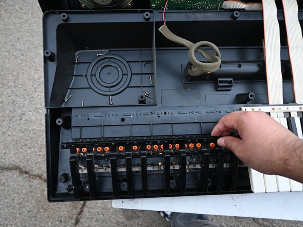

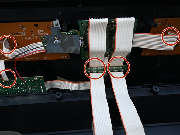

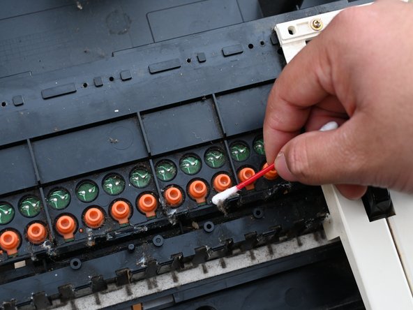

  5. How to Fix Unresponsive Keys for an Optimus Concertmate 980: step 5, image 1 of 2 How to Fix Unresponsive Keys for an Optimus Concertmate 980: step 5, image 2 of 2
    • Reattach any loose cables.
    • Clean any dust from the top of the keys with a vacuum or cotton swab.

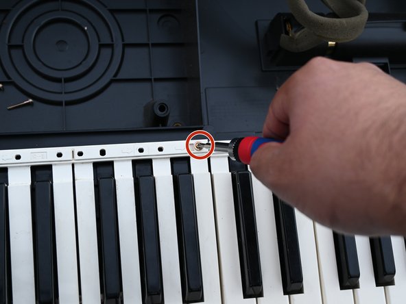

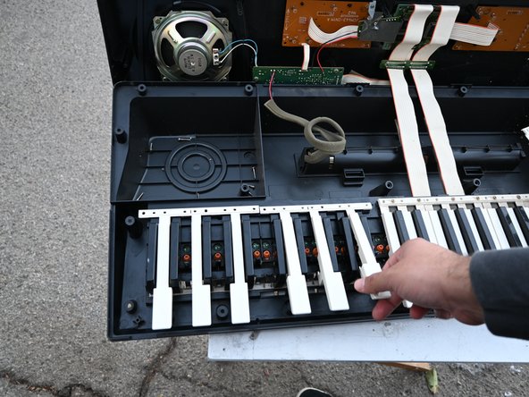

  6. How to Fix Unresponsive Keys for an Optimus Concertmate 980: step 6, image 1 of 2 How to Fix Unresponsive Keys for an Optimus Concertmate 980: step 6, image 2 of 2
    • Using a Phillips #00 screwdriver, remove all the screws attached to the top of the keys.

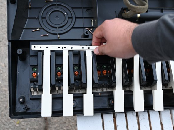

  7. How to Fix Unresponsive Keys for an Optimus Concertmate 980: step 7, image 1 of 3 How to Fix Unresponsive Keys for an Optimus Concertmate 980: step 7, image 2 of 3 How to Fix Unresponsive Keys for an Optimus Concertmate 980: step 7, image 3 of 3
    • Remove the white keys by pulling them from the top and sliding them down.
    • To remove the black keys, pull on the keys first to pull off, then remove the keys entirely.

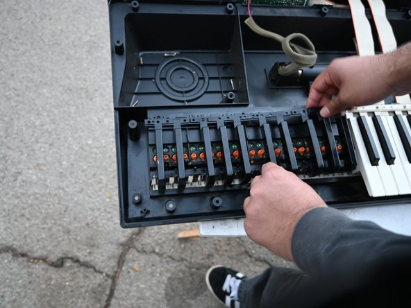

  8. How to Fix Unresponsive Keys for an Optimus Concertmate 980: step 8, image 1 of 3 How to Fix Unresponsive Keys for an Optimus Concertmate 980: step 8, image 2 of 3 How to Fix Unresponsive Keys for an Optimus Concertmate 980: step 8, image 3 of 3
    • Clean all the dust under the keys.
    • Clean around the orange tips, making sure they are upright.
  9. How to Fix Unresponsive Keys for an Optimus Concertmate 980: step 9, image 1 of 3 How to Fix Unresponsive Keys for an Optimus Concertmate 980: step 9, image 2 of 3 How to Fix Unresponsive Keys for an Optimus Concertmate 980: step 9, image 3 of 3
    • Place the keys in the same order as you took them out.
    • Using a Phillips screwdriver, replace all the screws in the same places as you removed them.
