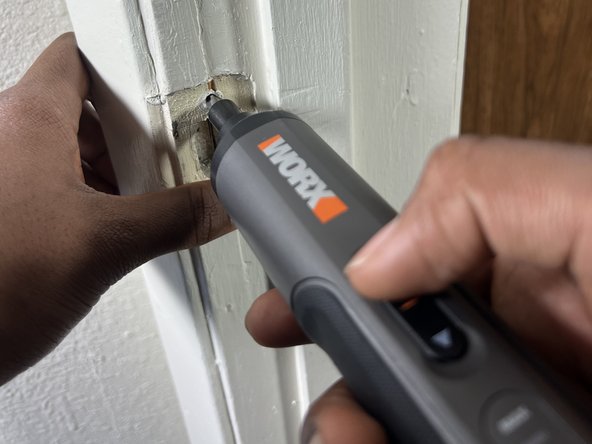

    • Using your screwdriver, unscrew the top screw of the strike plate.
    • After unscrewing the first screw, remove the second screw as well.
    • Make sure to record the dimensions of the screw for the drill bit.
    • Remove the strike plate.

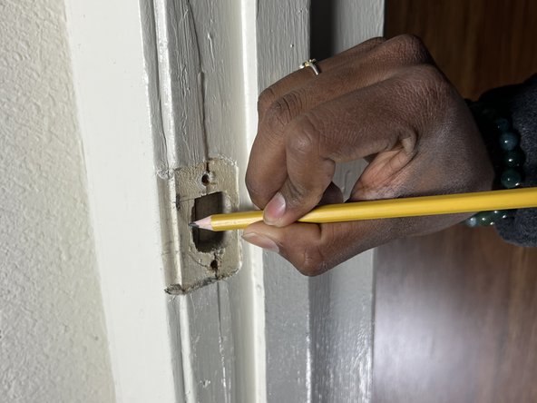

    • Locate where the door latch makes contact with the door frame.
  3. How to Fix The Hole For a Misaligned Door Latch: step 3, image 1 of 1
    • Using your writing utensil, mark the spot on the door frame where the door latch makes contct.

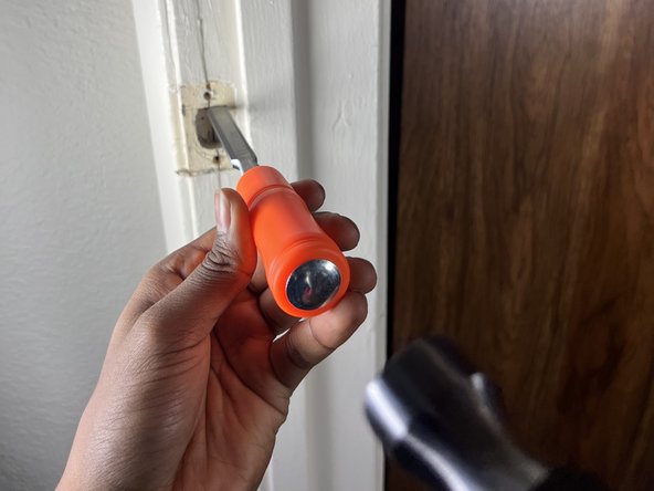

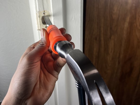

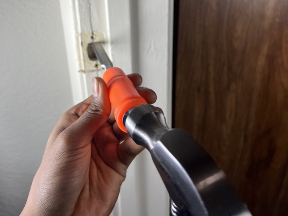

  4. How to Fix The Hole For a Misaligned Door Latch: step 4, image 1 of 3 How to Fix The Hole For a Misaligned Door Latch: step 4, image 2 of 3 How to Fix The Hole For a Misaligned Door Latch: step 4, image 3 of 3
    • Chisel out the wood, using the guideline you just created, that is keeping the latch from entering the hole.
    • Start at the top of the guideline, then work on the sides to create the new hole.

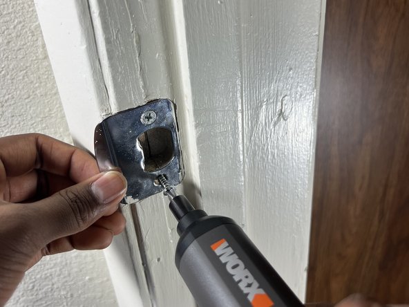

  5. How to Fix The Hole For a Misaligned Door Latch: step 5, image 1 of 1
    • Grab the strike plate and place it up against the new hole to ensure it is the right size.
    • If the hole is not the right size, repeat steps 2-4.

    • Place the strike plate into the new hole.
    • Screw in the top screw, then screw the bottom screw.
    • Congratulations, your repair is now complete!

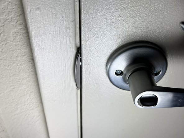

Now that the repair is complete, check that the door latch fits into the hole and that the door is able to close properly.
