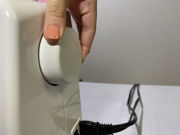

How to Fix Take-up Lever Thread Jam on a Baby Lock Joy
  1. How to Fix Take-up Lever Thread Jam on a Baby Lock Joy, How to Fix Take-up Lever Thread Jam on a Baby Lock Joy: step 1, image 1 of 1
    • Turn off the sewing machine.
  2. How to Fix Take-up Lever Thread Jam on a Baby Lock Joy: step 2, image 1 of 2 How to Fix Take-up Lever Thread Jam on a Baby Lock Joy: step 2, image 2 of 2
    • Remove the screw located behind the sewing machine.
  3. How to Fix Take-up Lever Thread Jam on a Baby Lock Joy: step 3, image 1 of 2 How to Fix Take-up Lever Thread Jam on a Baby Lock Joy: step 3, image 2 of 2
    • Remove the face plate of the sewing machine.
  4. How to Fix Take-up Lever Thread Jam on a Baby Lock Joy: step 4, image 1 of 1
    Tool used on this step:
    Buy
    • Grab the tail of the sewing thread with tweezers.
  5. How to Fix Take-up Lever Thread Jam on a Baby Lock Joy: step 5, image 1 of 1
    • Turn the hand wheel in the opposite direction of the thread so the thread can become untangled.
  6. How to Fix Take-up Lever Thread Jam on a Baby Lock Joy: step 6, image 1 of 1
    • Continue to pull the thread away from the take-up lever until the entire thread comes out.
  7. How to Fix Take-up Lever Thread Jam on a Baby Lock Joy: step 7, image 1 of 1
    • Set the take-up lever in its highest position.
To reassemble your device, follow steps two and three in reverse order.
