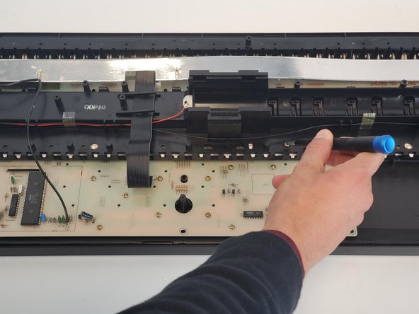

  7. How to Fix Stuck Yamaha PSR-6 Keyboard Keys: step 7, image 1 of 2 How to Fix Stuck Yamaha PSR-6 Keyboard Keys: step 7, image 2 of 2
    • Remove all the 10 mm screws on the top of the keys using a Phillips #1 screwdriver.
  8. How to Fix Stuck Yamaha PSR-6 Keyboard Keys: step 8, image 1 of 1
    • Use a spudger to separate the teeth to the plates that hold the keys together.
    • Do this gently as the plate may be fragile.
  9. How to Fix Stuck Yamaha PSR-6 Keyboard Keys: step 9, image 1 of 1
    • Pull the black plate that holds the keys together horizontally away from the keys.
    • With the top of the keys exposed, use a damp cloth or wipes to clean the space between the tiles.
