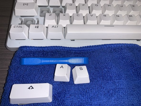

    • Remove all keycaps that feel stuck or sticky with a keycap puller or similar tool.
    • Some keycaps may feel tough to pull off. Ensure that even force is applied to all contact points with the keycap and keycap puller.

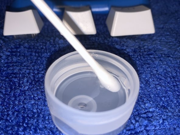

    • Soak a cotton swab in alcohol.
    • Potential for device damage: Ensure that the cotton swab is not too damp. Excess alcohol may reach deep inside the keyboard housing, potentially damaging electrical components.

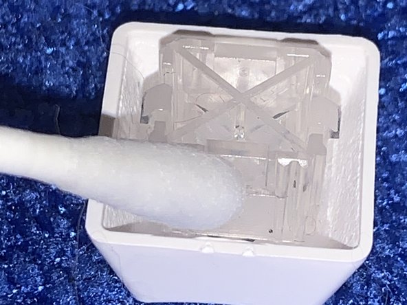

    • Clean the sides of the switch housing using the cotton swab.
    • Typically the surfaces of the switch stem, that come in contact with the housing, build up dirt that leads to keys feeling stuck or sticky. Pay close attention to these areas.
