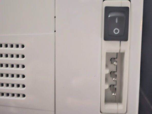

    • Ensure the power button on the machine is switched to the "off" position and the pedal is disconnected from the port at the side.

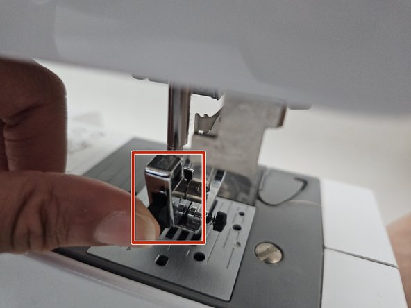

    • Remove the bobbin case by gripping the bobbin case cover with two fingers and sliding it back gently.
    • Remove the presser foot by pressing the black button at the back of the presser foot lever until the attached presser foot falls off.

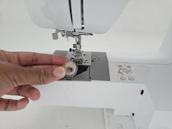

  4. How to Fix Stuck Feed Dogs on a Brother BM3700 Sewing Machine: step 4, image 1 of 3 How to Fix Stuck Feed Dogs on a Brother BM3700 Sewing Machine: step 4, image 2 of 3 How to Fix Stuck Feed Dogs on a Brother BM3700 Sewing Machine: step 4, image 3 of 3
    • Remove the bobbin from the bobbin case.

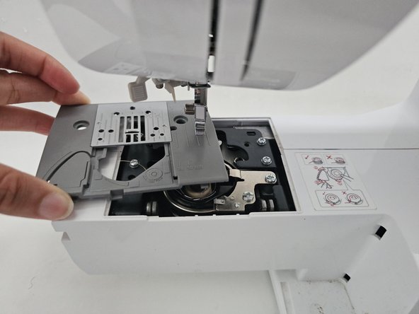

  5. How to Fix Stuck Feed Dogs on a Brother BM3700 Sewing Machine: step 5, image 1 of 1
    • Remove the bed cover to expose the feed dogs.

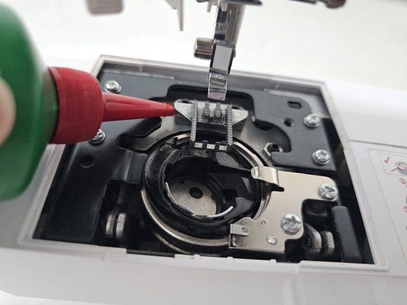

  7. How to Fix Stuck Feed Dogs on a Brother BM3700 Sewing Machine: step 7, image 1 of 3 How to Fix Stuck Feed Dogs on a Brother BM3700 Sewing Machine: step 7, image 2 of 3 How to Fix Stuck Feed Dogs on a Brother BM3700 Sewing Machine: step 7, image 3 of 3
    • Apply 2 drops of sewing machine oil to the left and right sides of the feed dog.
    • Wipe away excess oil using the microfiber cloth.
  8. How to Fix Stuck Feed Dogs on a Brother BM3700 Sewing Machine: step 8, image 1 of 1
    • Move the feed dogs manually by turning the hand crank clockwise for 3 full rotations in order to disperse the oil evenly.

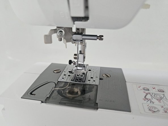

  9. How to Fix Stuck Feed Dogs on a Brother BM3700 Sewing Machine: step 9, image 1 of 1
    • Replace the bed cover, bobbin plate, presser foot, and the needle into the machine.

1. Switch on and replug the machine
2. Replace the needle
3. Replace the bobbin plate and the presser foot attachment
4. Replace the bobbin and the screws on the bed cover using the round screwdriver.
5. Replace the bed cover.
