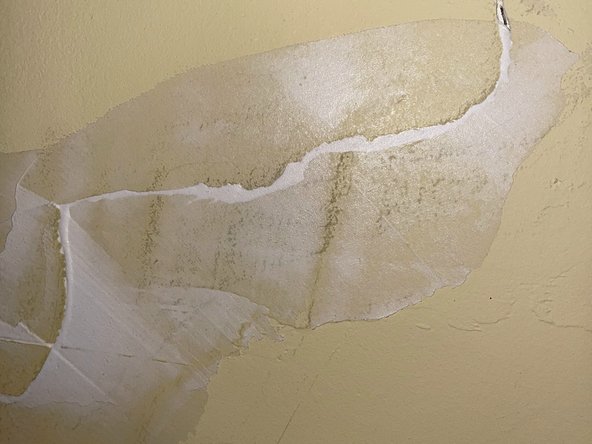

    • Use a box cutter knife to widen the crack of the drywall a bit.
    • Get the box cutter in between the cracks of the dry wall and attempt to create a gap within the drywall.

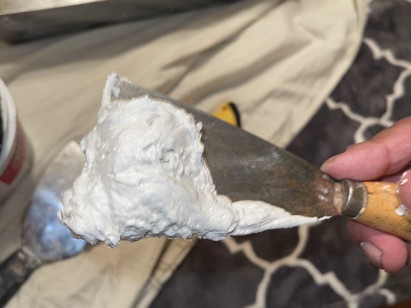

    • With the drywall crack having a gap now, get some putty; it may vary depending on how much you need. With the damage on my drywall, I used around this amount.
  4. How to Fix Cracked Dry Wall: step 4, image 1 of 2 How to Fix Cracked Dry Wall: step 4, image 2 of 2
    • Scrape the putty onto the Paint pan to keep things clean and in one place without fear of using something smaller like the putty cup which may tip over easily. This is to prevent accidental spillage and stains on furniture, etc.

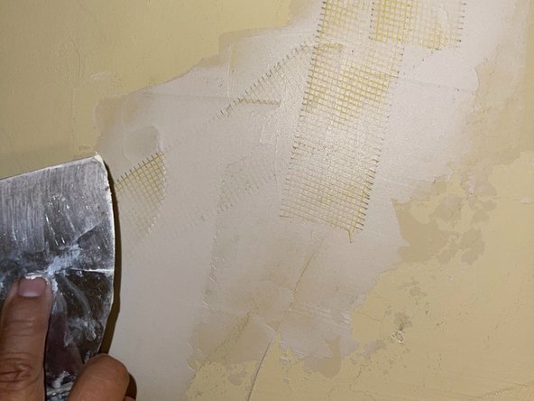

    • Now apply the putty to the affected areas. Press the putty into the crack you widened. That will allow the putty to go in the gap and reinforce the drywall.
    • Use an up and down motion covering the crack on the drywall if it's horizontal. You may also need to move your hand left to right if it's vertical.

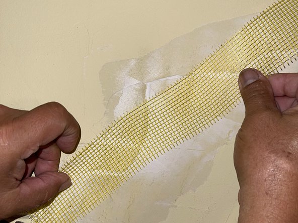

    • Next, use the mesh fiber tape and overlay it over where you applied the putty.
    • Before cutting, you may want to unwrap the tape and measure and adjust it according to the size and length of the crack.

    • Now with the mesh tape (fiber tape) attached to the cracked parts of the drywall and putty, apply more putty over the mesh tape.
    • Use the same method from step 5 and cover the area thoroughly.

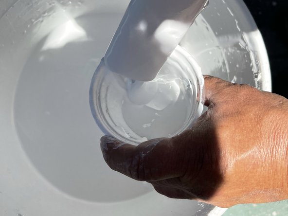

    • Grab some base paint. Stir the paint to ensure it is evenly mixed. Use a clockwise or counterclockwise motion while stirring. After that, get a cup and pour some paint into it.
