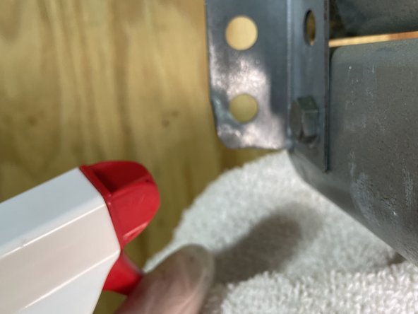

  2. How to Fast Fix a sharp edge on a garage door: step 2, image 1 of 2 How to Fast Fix a sharp edge on a garage door: step 2, image 2 of 2
    • Spray the cleaning solution on the sharp edge of the garage door railing and the metal file.

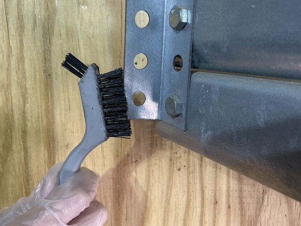

    • Remove the debris from the sharp edge of the garage door using a brush.

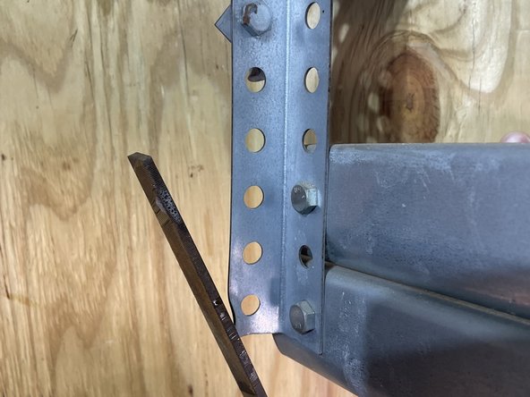

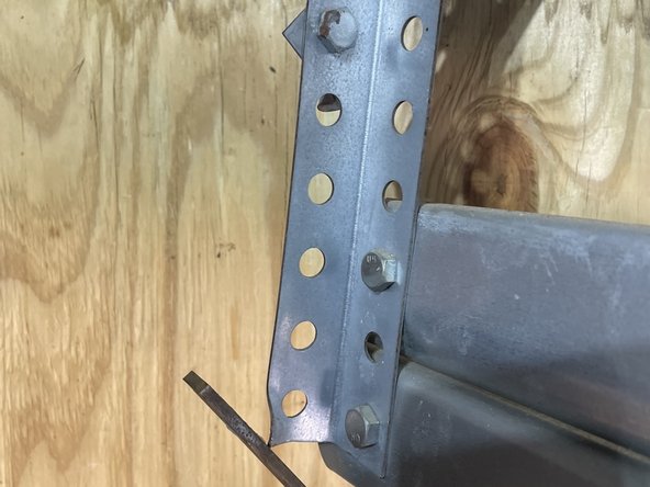

  4. How to Fast Fix a sharp edge on a garage door: step 4, image 1 of 3 How to Fast Fix a sharp edge on a garage door: step 4, image 2 of 3 How to Fast Fix a sharp edge on a garage door: step 4, image 3 of 3
    • Use the metal file to bevel the sharp edge of the garage door by grinding against it in a curved motion.

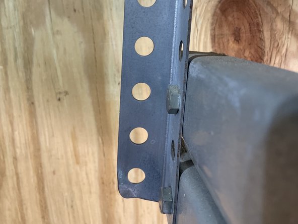

  5. How to Fast Fix a sharp edge on a garage door: step 5, image 1 of 1
    • Use the metal brush to clear the debris from the beveled edge.
  6. How to Fast Fix a sharp edge on a garage door: step 6, image 1 of 2 How to Fast Fix a sharp edge on a garage door: step 6, image 2 of 2
    • Clean the beveled edge using the rag and the cleaning solution.
Assess the sharpness of the edge and bevel further if necessary.
