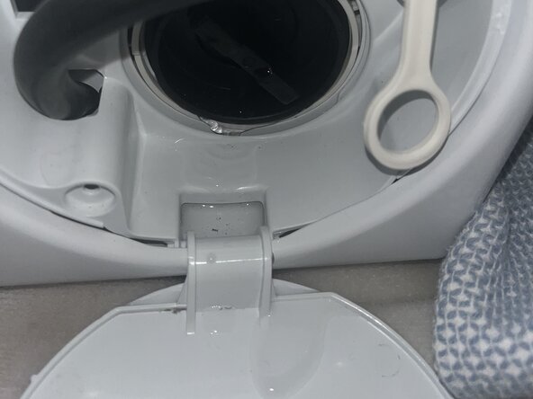

  3. How to Clean the Filter of a GE 24" Front-Loading Washing Machine: step 3, image 1 of 1
    • Twist the filter knob counterclockwise to release it.
    • It's suggested to not open all the way, to allow the water to release slowly.
    • Allow water to drain fully into container or rags.
    Ask FixBot
  4. How to Clean the Filter of a GE 24" Front-Loading Washing Machine: step 4, image 1 of 2 How to Clean the Filter of a GE 24" Front-Loading Washing Machine: step 4, image 2 of 2
    • Once all the water has drained, pull the filter out completely.
    • Keep an eye out for foreign objects, like hairpins, buttons, or coins.

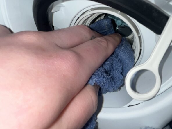

  6. How to Clean the Filter of a GE 24" Front-Loading Washing Machine: step 6, image 1 of 2 How to Clean the Filter of a GE 24" Front-Loading Washing Machine: step 6, image 2 of 2
    • Wipe down the area inside the filter housing.
    • Insert the cleaned filter back into the housing.
    • Twist clockwise until secured—do not overtighten.
