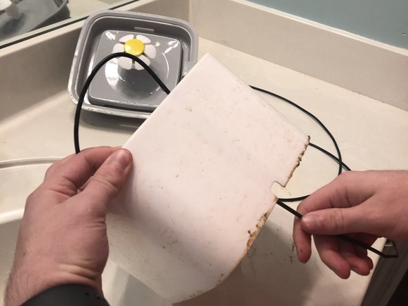

    • Remove the wire attached to to the pump to free it from the fountain by unplugging the cord from the AC adapter. Then take the end of the wire and push it through the open hole.

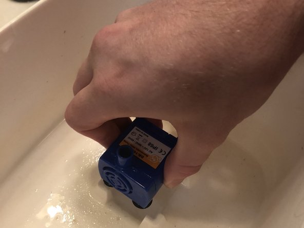

    • Remove the pump from the fountain by grabbing both sides of the pump and the basin, then pulling the pump out.

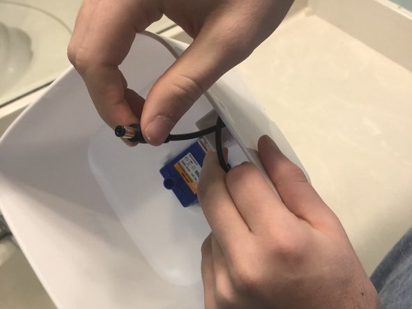

    • Feed the wire back through the channel in the side of the fountain.
