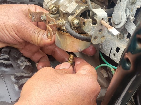

  8. How to Clean a YardWork LH3185A Snow Blower Carburetor: step 8, image 1 of 3 How to Clean a YardWork LH3185A Snow Blower Carburetor: step 8, image 2 of 3 How to Clean a YardWork LH3185A Snow Blower Carburetor: step 8, image 3 of 3
    • Remove the bolt that holds the reservoir in place using a 13mm socket or spanner.
    • Gas can leak when removing the jet, so have a bucket or towel in place.
  9. How to Clean a YardWork LH3185A Snow Blower Carburetor: step 9, image 1 of 1
    • Remove the reservoir by pulling downwards.

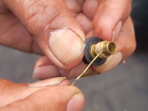

  10. How to Clean a YardWork LH3185A Snow Blower Carburetor: step 10, image 1 of 2 How to Clean a YardWork LH3185A Snow Blower Carburetor: step 10, image 2 of 2
    • Clean the jet nozzle (all three holes) using a pin or small wire.
