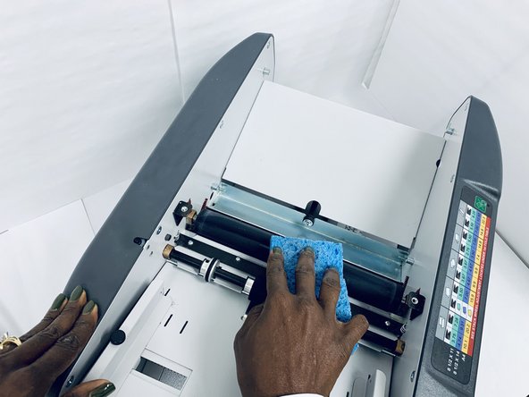

    • Apply your dish soap to a small dampened sponge.
    • Make sure not to over soak the sponge or add too much soap.
  5. How to Clean a Martin Yale 1611 Folding Machine: step 5, image 1 of 3 How to Clean a Martin Yale 1611 Folding Machine: step 5, image 2 of 3 How to Clean a Martin Yale 1611 Folding Machine: step 5, image 3 of 3
    • Carefully rub the sponge along each roller.
    • Turn each roller as you clean it to ensure it is completely cleaned.
    • Any dark (black) residue present on the sponge indicates an ink build up, so continue cleaning until all residue is gone.
Before reassembling, make sure all of the rollers are dry (you may use a cotton cloth). To reassemble your device, follow steps 1-3 in reverse order.
