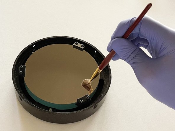

  5. How to Clean a Celestron PowerSeeker 127EQ Telescope's Primary Mirror: step 5, image 1 of 3 How to Clean a Celestron PowerSeeker 127EQ Telescope's Primary Mirror: step 5, image 2 of 3 How to Clean a Celestron PowerSeeker 127EQ Telescope's Primary Mirror: step 5, image 3 of 3
    • Lay the back panel flat on a table with the mirror facing upwards and grab a camel hair brush.
    • To remove dust particles, lightly brush the mirror's surface starting in the center and pulling out towards the edge of the mirror.
    • Perform center to edge strokes 360 degrees around the mirror.

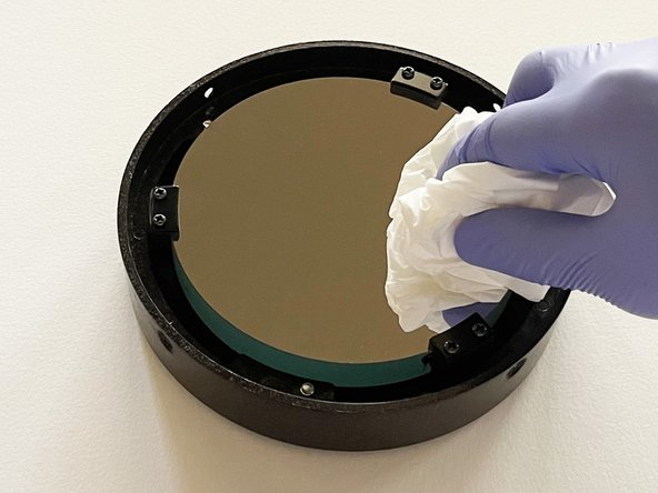

    • To remove tougher build up, take the spray solution and disperse 4-5 sprays onto a tissue paper.
  7. How to Clean a Celestron PowerSeeker 127EQ Telescope's Primary Mirror: step 7, image 1 of 3 How to Clean a Celestron PowerSeeker 127EQ Telescope's Primary Mirror: step 7, image 2 of 3 How to Clean a Celestron PowerSeeker 127EQ Telescope's Primary Mirror: step 7, image 3 of 3
    • Applying minimal pressure, mimic the same strokes as the brush by pulling the moist side of the tissue from the center to the edge of the mirror.
    • Perform these strokes 360 degrees around the mirror.
    • If build up still remains, repeat the motions above with more pressure but just enough to remove the build up.
