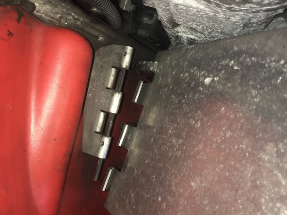

      • Remove the side panel.
      • Pull the 2 rubber straps off.
      • Pull the panel up and out.

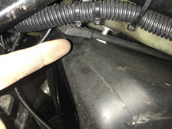

      • Remove the belt cover by removing the pin.

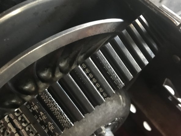

    3. How to Clean Mikuni Snowmobile Carburetor: step 3, image 1 of 3 How to Clean Mikuni Snowmobile Carburetor: step 3, image 2 of 3 How to Clean Mikuni Snowmobile Carburetor: step 3, image 3 of 3
      • Use the secondary tool to expand the clutch. Turn clockwise.
      • After this is done, roll the belt over the clutch to remove belt. Rolling the belt towards the back end of the machine.

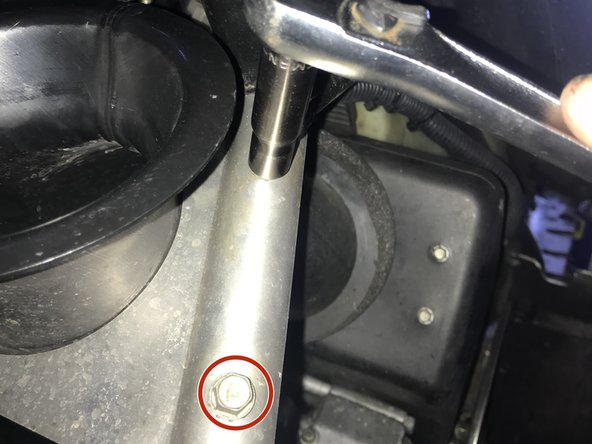

      • Using a 3/8"(9.525 mm) socket on the 3/8" ratchet, remove the air horn bolts, and pull the air horn out.

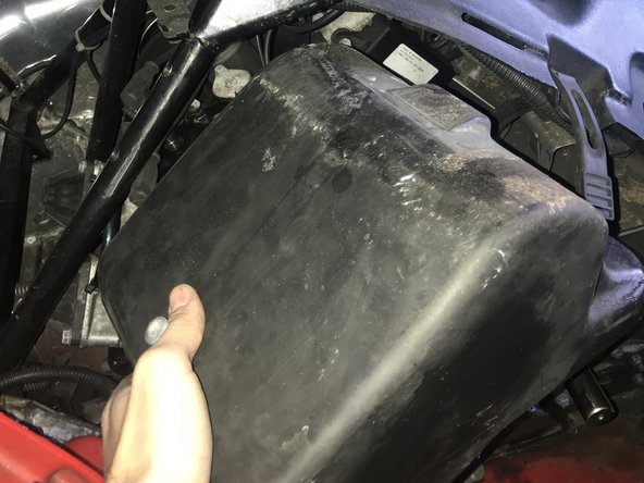

    6. How to Clean Mikuni Snowmobile Carburetor: step 6, image 1 of 3 How to Clean Mikuni Snowmobile Carburetor: step 6, image 2 of 3 How to Clean Mikuni Snowmobile Carburetor: step 6, image 3 of 3
      • Pull the rubber strap off of the air box.
      • Remove the airbox by pulling the box up and out towards yourself.
      • Caution: Be careful of pulling wires and cables.

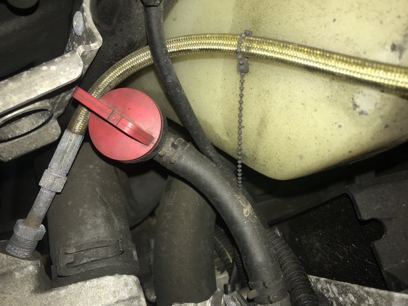

    7. How to Clean Mikuni Snowmobile Carburetor: step 7, image 1 of 2 How to Clean Mikuni Snowmobile Carburetor: step 7, image 2 of 2

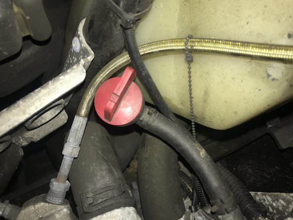

      • Turn the fuel off by turning the red fuel knob to the off position so that it is perpendicular to the hose.
      • Note: straight piece on knob that is in line with hose means open. Perpendicular to the fuel hose means it is closed. (i.e. picture 2)

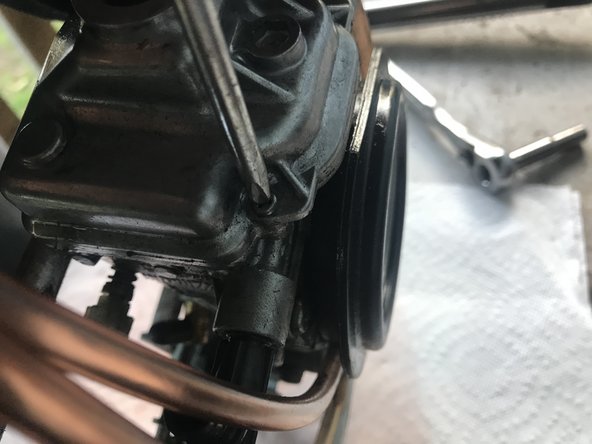

    8. How to Clean Mikuni Snowmobile Carburetor: step 8, image 1 of 3 How to Clean Mikuni Snowmobile Carburetor: step 8, image 2 of 3 How to Clean Mikuni Snowmobile Carburetor: step 8, image 3 of 3
      • Using a flat head screw driver, loosen the hose clamps on the carburetor boots so that it can be removed later.

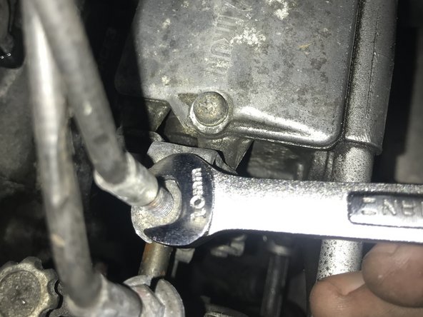

      • Using a 10 mm open ended box wrench, loosen the top and bottom nuts on the choke and throttle cable that are attached to the carburetor.

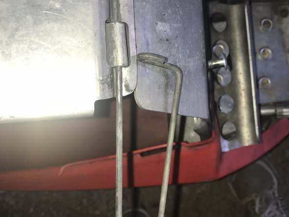

      • Pull the carburetor off so that it can be rotated to the side.
      • Pull the choke and throttle cables off by sliding cable through slots.

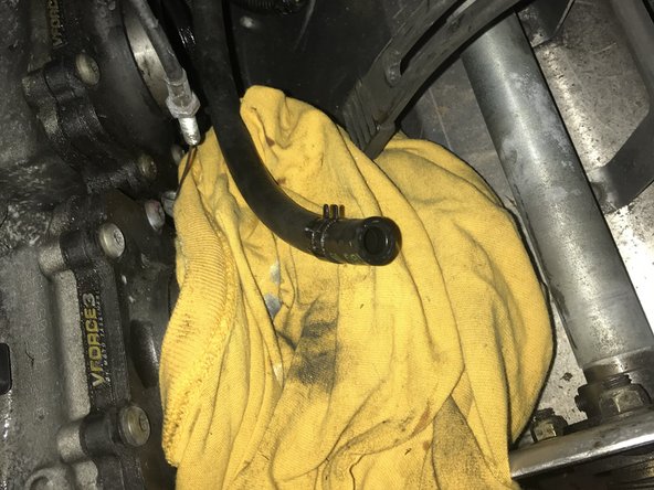

      • Using a needle nose pliers, remove the hose clamp from the fuel hose that leads to the fuel rail.
      • Pull the fuel line off of the fuel rail connector. Be careful to not break the hose and/or connector.
      • Set a rag underneath the carb and fuel line to catch the fuel that pours out.

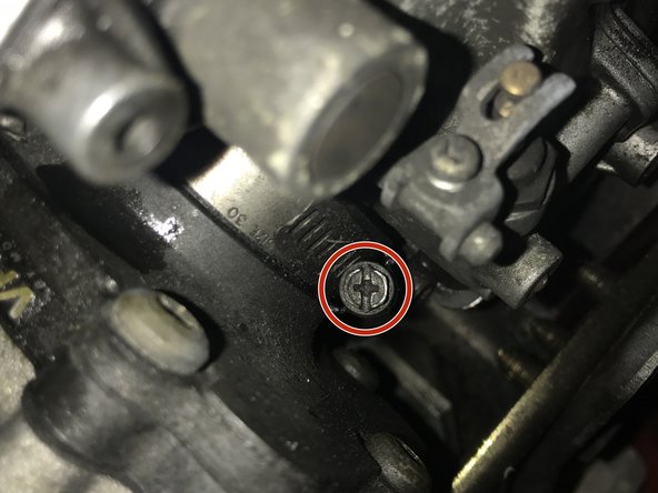

    14. How to Clean Mikuni Snowmobile Carburetor: step 14, image 1 of 3 How to Clean Mikuni Snowmobile Carburetor: step 14, image 2 of 3 How to Clean Mikuni Snowmobile Carburetor: step 14, image 3 of 3
      • Using a #2 Phillips head screw driver, remove the screw holding the bottom cover on.
      • Be cautious of the gasket falling out of slot on the cover.

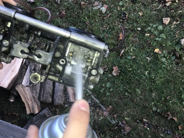

      • Use the carburetor cleaner to spray the floats and pilot air jet.

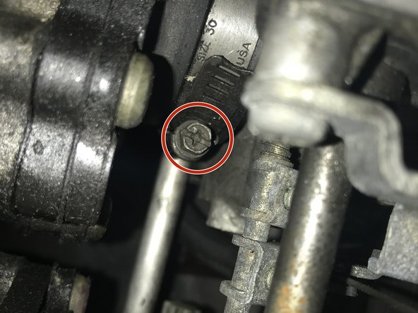

    16. How to Clean Mikuni Snowmobile Carburetor: step 16, image 1 of 2 How to Clean Mikuni Snowmobile Carburetor: step 16, image 2 of 2
      • Remove the 4 screws using a #2 Phillips screw driver that connect the top plate to carbs.
      • Caution: the gasket can be removed with top cover plate.
