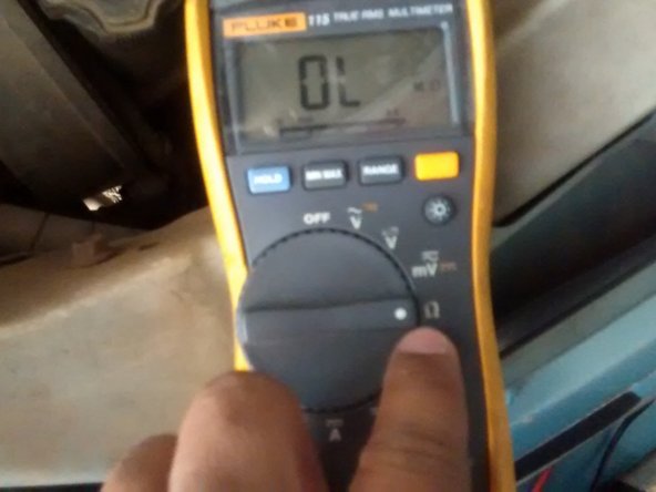

  3. How to Check Resistance of Suzuki Wagon R Temperature Sensor, Measure Resistance: step 4, image 1 of 3 How to Check Resistance of Suzuki Wagon R Temperature Sensor, Measure Resistance: step 4, image 2 of 3 How to Check Resistance of Suzuki Wagon R Temperature Sensor, Measure Resistance: step 4, image 3 of 3
    • Turn the knob in the multimeter to set the test to Ohms/Resistance
    • Connect the terminal 1 and 2 of the component Intake air temperature sensor to Multimeter positive and negative
    • The set value at ignition on and engine cold is 1.3KOhms
