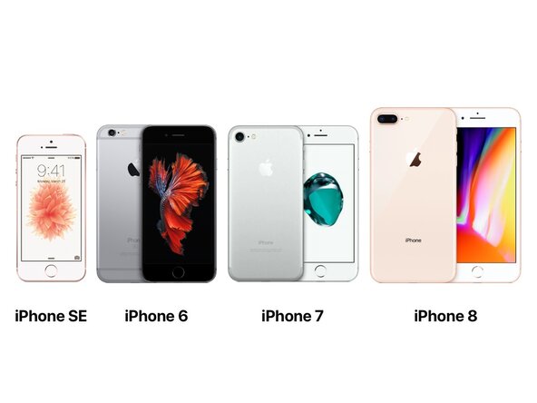

    1. How to Bypass Activation Lock with Lockra1n, Supported Devices: step 1, image 1 of 1
      • Currently Supported iPhones:
      • iPhone 6s & iPhone 6s Plus
      • iPhone SE (1st generation)
      • iPhone 7 & iPhone 7 Plus
      • iPhone 8 & iPhone 8 Plus
      • iPhone X (Still in active development, expect bugs)
      • This tool claims it can also bypass select iPad models. However, I have not tested this yet and therefore cannot verify.
      • If you have a device older than the A9 chip (such as iPhone 5s), you can bypass the Activation Lock with Passra1n. I will make a guide explaining how to use this software in the future.

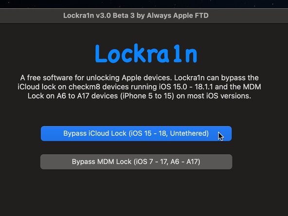

    6. How to Bypass Activation Lock with Lockra1n, Preparing for Bypass: step 6, image 1 of 1
      • At this point, connect the iPhone to your Mac and choose Bypass iCloud Lock (iOS 15 - 18, Untethered)

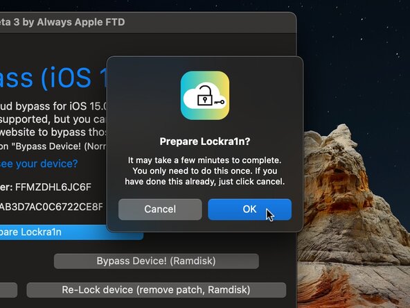

    7. How to Bypass Activation Lock with Lockra1n: step 7, image 1 of 3 How to Bypass Activation Lock with Lockra1n: step 7, image 2 of 3 How to Bypass Activation Lock with Lockra1n: step 7, image 3 of 3
      • Then choose Prepare Lockr1n
      • This will install certain scripts needed to bypass the iPhone.
      • Then choose OK
      • Click OK when finished
      • You may get an error when installing these scripts. If this happens you will need to open a new Terminal window and type these two commands, and then click Prepare Lockra1n again:
      • xcode-select --install
      • brew install libxml2
      • If the second command does not work, you will need to install Homebrew onto your Mac: Install Homebrew

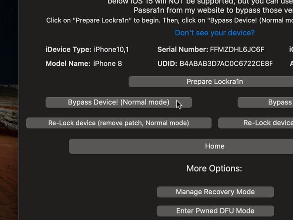

    8. How to Bypass Activation Lock with Lockra1n, Registering your iPhone: step 8, image 1 of 3 How to Bypass Activation Lock with Lockra1n, Registering your iPhone: step 8, image 2 of 3 How to Bypass Activation Lock with Lockra1n, Registering your iPhone: step 8, image 3 of 3
      • Once competed, you will need to register your iPhone in order to create the Activation Records.
      • You do not need to create an account, nor give your card info. This tool is completely free of charge.
      • Choose Bypass Device! (Normal Mode)
      • Choose Continue in order for the app to verify if your iPhone has been registered
      • Then choose Visit Registration Page in order to register your iPhone. This will open your web browser.

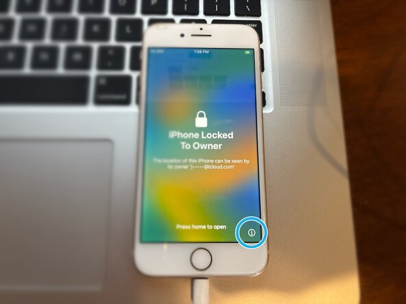

    9. How to Bypass Activation Lock with Lockra1n: step 9, image 1 of 3 How to Bypass Activation Lock with Lockra1n: step 9, image 2 of 3 How to Bypass Activation Lock with Lockra1n: step 9, image 3 of 3
      • Scroll to the bottom of the page. There you will see Enter your Apple Device Serial Number:
      • To find your iPhone serial number, wake your iPhone and press the i in the bottom right corner of the screen. You will see SN followed by a code containing both numbers and letters. This is the serial number.
      • Type this number into the box on the site

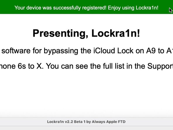

    10. How to Bypass Activation Lock with Lockra1n: step 10, image 1 of 2 How to Bypass Activation Lock with Lockra1n: step 10, image 2 of 2
      • Once you have entered in your iPhone serial number, choose Register Device!
      • The page will refresh and you will see at the top a message that says Your device was successfully registered! Enjoy using Lockra1n!
      • You can now close this window and go back to the app.

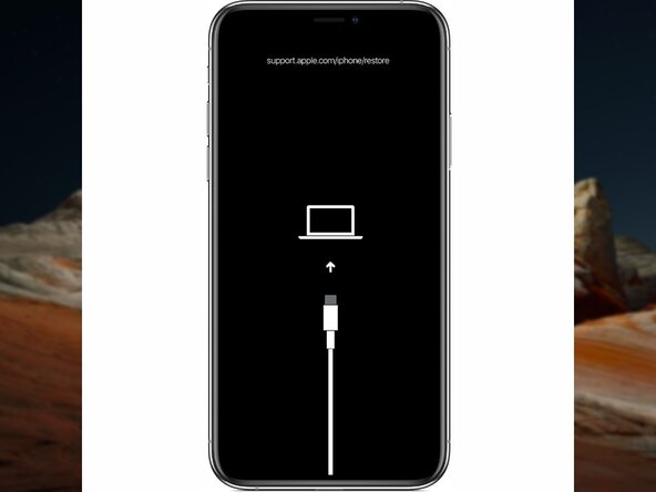

    12. How to Bypass Activation Lock with Lockra1n, Entering Recovery Mode: step 12, image 1 of 2 How to Bypass Activation Lock with Lockra1n, Entering Recovery Mode: step 12, image 2 of 2
      • Entering DFU mode on an iPhone can be quite tricky and require many attempts. Be patient, and read all the steps before attempting.
      • You cannot enter DFU mode with a Mac that only has USB-C. To enter DFU mode, you must connect your iPhone to a Mac via an official Apple Lightning cable using USB-A. If you do not have access to a Mac with USB-A, you must find a Powered USB-C hub that supports USB-A.
      • To begin, you must put your iPhone in Recovery Mode
      • For iPhone 6s, 6s Plus, SE models, disconnect the iPhone from your Mac and power it off. Then, reconnect it to your Mac and immediately press and hold the Home Button until the iPhone enters Recovery Mode.
      • For iPhone 7, 7 Plus models, keep your iPhone connected to the Mac and press the Side button and Volume Down button until the device enters Recovery Mode.
      • For iPhone 8, 8 Plus, X models, keep your iPhone connected to the Mac and quick press the Volume Up button, quick press the Volume Down button, then press and hold the Side button until the device enters Recovery Mode.

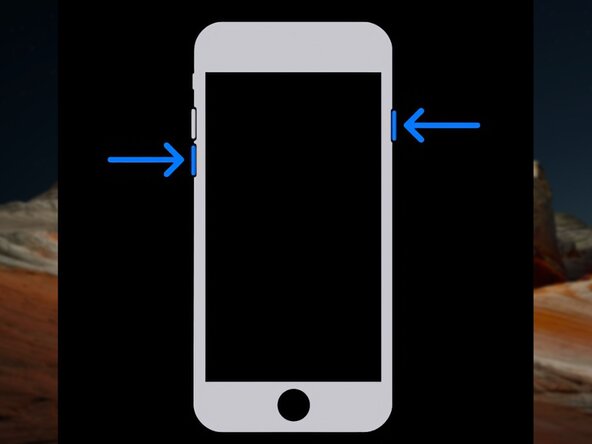

    13. How to Bypass Activation Lock with Lockra1n: step 13, image 1 of 1
      • Once in Recovery Mode, follow these steps to enter DFU mode:
      • For iPhone 6s, 6s Plus, SE models, press and hold both the Home button and the Lock button for 8 seconds. Then release the Lock button but continue to hold the Home button until the device enters DFU.
      • For iPhone 7, 7 Plus models, press and hold both the Side button and the Volume Down button for 8 seconds. Then release the Side button but continue to hold the Volume Down button until the device enters DFU.
      • For iPhone 8, 8 Plus, X models, quick press the Volume Up button, quick press the Volume Down button, press and hold the Side button for 10 seconds. Then press and hold the Volume Down button for five seconds. Then release the Side button and continue to hold the Volume Down button until the device enters DFU.
      • The iPhone will show a black screen when entered DFU. If you see an Apple logo during this process, you will need to retry.

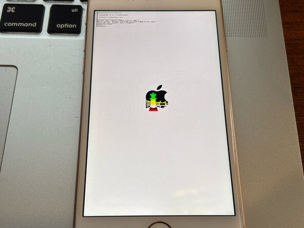

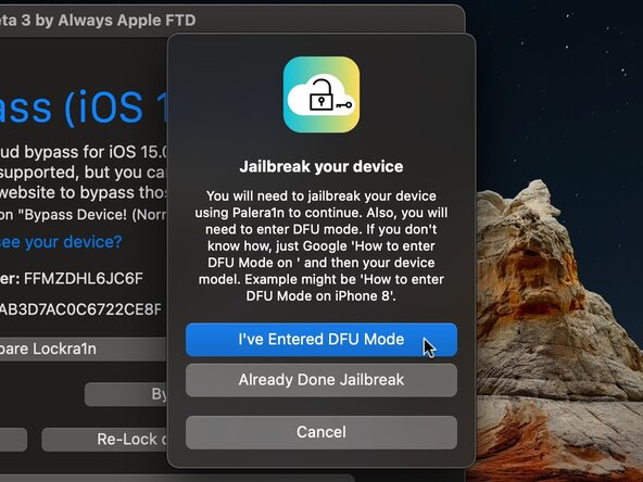

    14. How to Bypass Activation Lock with Lockra1n, Applying the Jailbreak: step 14, image 1 of 3 How to Bypass Activation Lock with Lockra1n, Applying the Jailbreak: step 14, image 2 of 3 How to Bypass Activation Lock with Lockra1n, Applying the Jailbreak: step 14, image 3 of 3
      • Once you have entered DFU mode, you can then apply the jailbreak.
      • Choose I've Entered DFU Mode in the app.
      • The iPhone will boot and show some text.

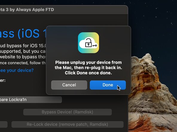

      • When the message appears in the app to unplug your device, disconnect the cable that plugs into your Mac (not your iPhone), and then plug it back in. Choose Done when you finish.

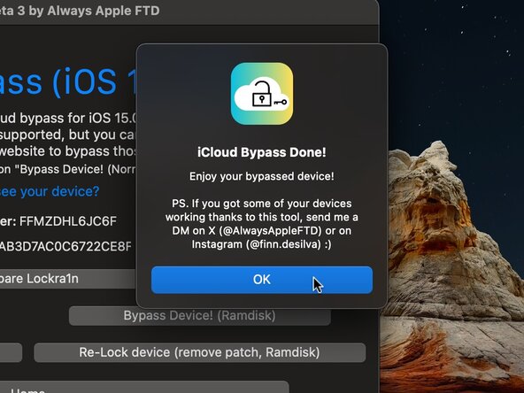

    15. How to Bypass Activation Lock with Lockra1n, Bypassing the Activation Lock: step 15, image 1 of 3 How to Bypass Activation Lock with Lockra1n, Bypassing the Activation Lock: step 15, image 2 of 3 How to Bypass Activation Lock with Lockra1n, Bypassing the Activation Lock: step 15, image 3 of 3
      • Once finished, the iPhone will boot back normally.
      • On iPhone X models, the jailbreak may not work properly. If fails, retry by putting it back into Recovery and starting over.
      • Wait until the hello screen comes back on your iPhone and then choose OK in the app.
      • Verify once more that the iPhone has fully booted, and choose OK in the app.
      • The app will bypass the Activation Lock and the iPhone will reboot.
      Ask FixBot
    16. How to Bypass Activation Lock with Lockra1n, Finishing Up: step 16, image 1 of 2 How to Bypass Activation Lock with Lockra1n, Finishing Up: step 16, image 2 of 2
      • The app will report the iPhone as Activated.
      • The iPhone may still appear to be locked, because it returns to the setup screen. However, after connecting to the internet, the iPhone will skip activation and go straight to Data and Privacy. You can continue to set up the iPhone.
