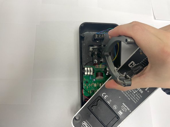

    • Remove all four of the 5 mm screws from the bottom panel of the pedal using a Phillips #1 screwdriver.
  2. How to Align the Envelope Modulator on a Dunlop Crybaby Pedal: step 2, image 1 of 3 How to Align the Envelope Modulator on a Dunlop Crybaby Pedal: step 2, image 2 of 3 How to Align the Envelope Modulator on a Dunlop Crybaby Pedal: step 2, image 3 of 3

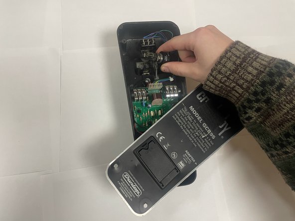

    • Twist away the bottom panel to expose the inner components.
    • Do not remove the bottom panel entirely.
    • Be sure not to pull too hard on the wires when twisting the bottom panel.

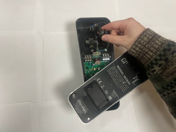

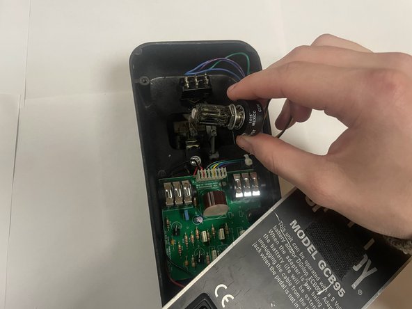

    • Locate and pick up the envelope modulator.
    • It will have a cylindrical gear attached to it.
  4. How to Align the Envelope Modulator on a Dunlop Crybaby Pedal: step 4, image 1 of 2 How to Align the Envelope Modulator on a Dunlop Crybaby Pedal: step 4, image 2 of 2
    • Move the nut and washer to the upper section of the thread.
