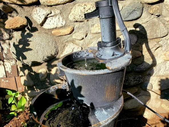

How to Adjust a Garden Fountain Hose
  1. How to Adjust a Garden Fountain Hose, How to Adjust a Garden Fountain Hose: step 1, image 1 of 3 How to Adjust a Garden Fountain Hose, How to Adjust a Garden Fountain Hose: step 1, image 2 of 3 How to Adjust a Garden Fountain Hose, How to Adjust a Garden Fountain Hose: step 1, image 3 of 3
    • Turn off and unplug the fountain.
    • Remove the water from the fountain using a cup.
    • Empty the water into a bucket and place the bucket off to the side and out of the way.

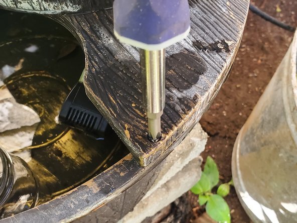

  2. How to Adjust a Garden Fountain Hose: step 2, image 1 of 3 How to Adjust a Garden Fountain Hose: step 2, image 2 of 3 How to Adjust a Garden Fountain Hose: step 2, image 3 of 3
    • Remove the screws along the edge of the platform on the bottom half of the fountain using a Phillips screwdriver.
    • Lift the upper half of the fountain upward while holding onto the water pump.

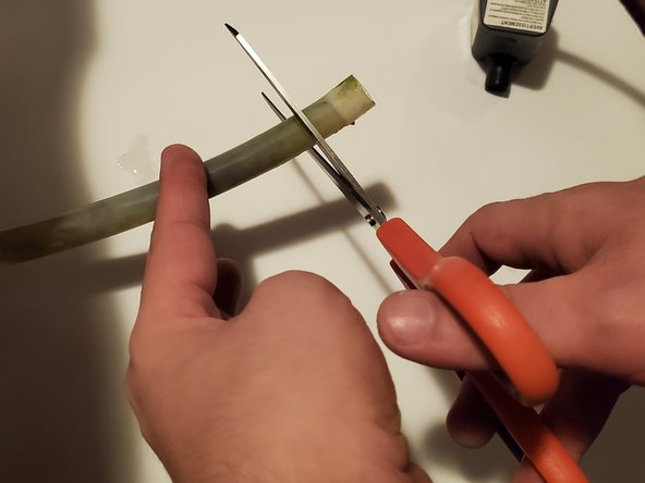

  3. How to Adjust a Garden Fountain Hose: step 3, image 1 of 3 How to Adjust a Garden Fountain Hose: step 3, image 2 of 3 How to Adjust a Garden Fountain Hose: step 3, image 3 of 3
    • Lay the upper half of the fountain on a flat surface such as a table.
    • Remove the hose from the water pump.
    • Cut the hose an inch and a half shorter from the original length using a pair of scissors.
