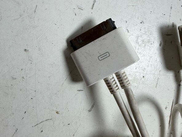

      • Get a 30-pin split or "Y" cable (or a Firewire iPod cable and a USB iPod cable).
      • Plug the Firewire cable (or plug) into the wall charger.
      • The USB plug is for syncing the iPod to your computer. With the "Y" cable you can do this while charging it from the wall charger.
      • If using a "Y" cable, do not plug the USB and Firewire plugs into the same computer. The USB and Firewire grounds must be separate.
