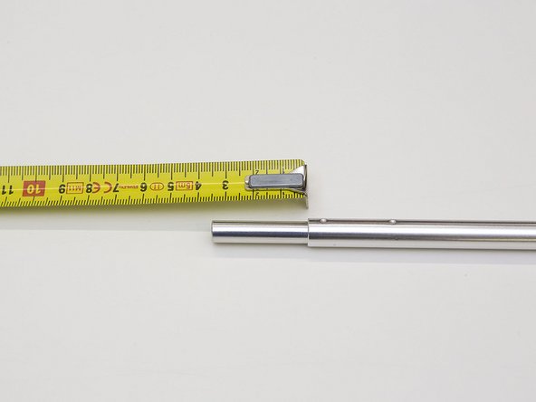

  5. How do I replace a broken segment of my tent pole?: step 6, image 1 of 3 How do I replace a broken segment of my tent pole?: step 6, image 2 of 3 How do I replace a broken segment of my tent pole?: step 6, image 3 of 3
    • To determine which replacement segment to order, measure the outer diameter of the pole and of the tapered end.
    • A caliper makes it easier to measure the diameter. If you don’t have one on hand, you can use a normal measuring tape.

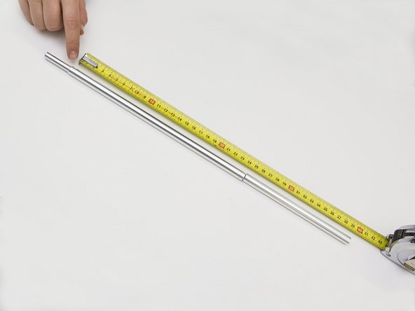

  6. How do I replace a broken segment of my tent pole?: step 7, image 1 of 2 How do I replace a broken segment of my tent pole?: step 7, image 2 of 2
    • Transfer the length of the broken segment to the new segment. Start measuring after the tapered end, and mark the length with a marker.
