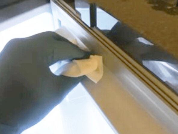

  3. How To Replace a Refrigerator Door Seal: step 3, image 1 of 2 How To Replace a Refrigerator Door Seal: step 3, image 2 of 2
    • Put on your gloves and use a baby wipe with water & soap to remove any loose dirt, or sealant remains.
    • Apply the water and soap mixture to remove any remaining dirt, and then dry it with a cloth.
    • Use a hair dryer on a low setting to dry the channel.

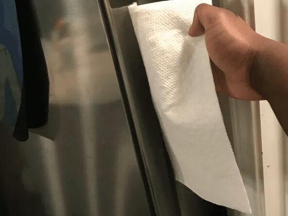

  6. How To Replace a Refrigerator Door Seal: step 6, image 1 of 1
    • Check for proper closure by using the paper test. Grab a piece of paper and try to fit it in between the gap of the seal. If it can fit, it is not installed properly and repeat step 5 again. If it is, then you may proceed.
    • Test multiple areas around the area, put more of your attention toward areas that are the hardest to install.
    • Make sure to test all areas and focus more on the hardest spots. The testing must be done in a careful manner.
    • Adjust gasket positioning if needed. When it fits, it won't be a satisfying click like putting a puzzle piece together. So, ensure it is fully positioned and finished before finishing. Retest if needed. If it is complete, then you are done.
