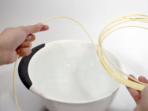

      • Soak the reed in a bowl of room temperature water for 15 minutes.
      • It should bend without snapping.

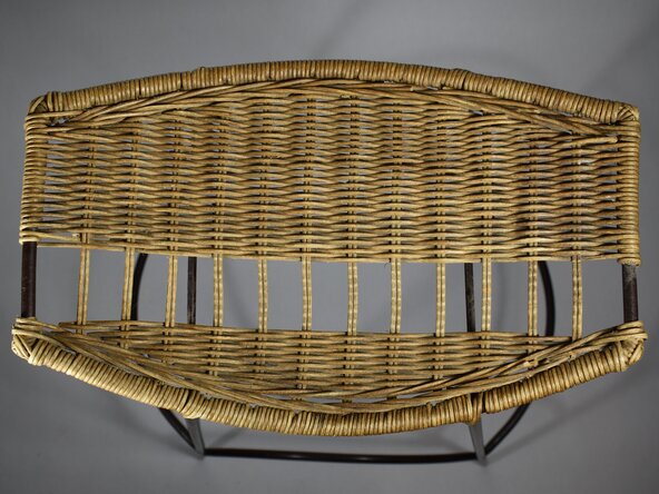

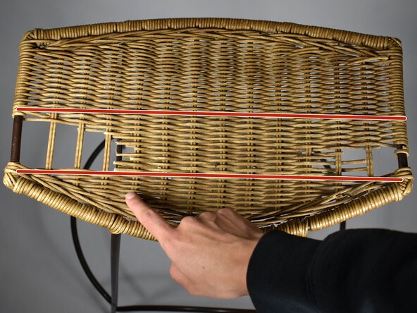

      • Identify the broken pieces; you will need to remove the whole row.
      Ask FixBot
    3. How To Fix A Wicker Chair Seat: step 3, image 1 of 2 How To Fix A Wicker Chair Seat: step 3, image 2 of 2
      • Using pliers or your hands, gently remove the broken pieces.
      • The old reeds will be brittle and will simply snap off.
      • Reed material is fragile; be careful not to remove more than you need to.

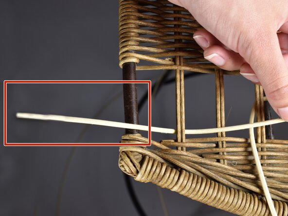

      • When you have completed a few passes, return to the beginning of your project and find the two inches of reed left unwoven.
      • Wrap the end of the reed around the rail twice.
      • Take the remaining reed and weave it into a gap in the existing weaving; it should stay in place.
      • Continue weaving the long end of the reed.

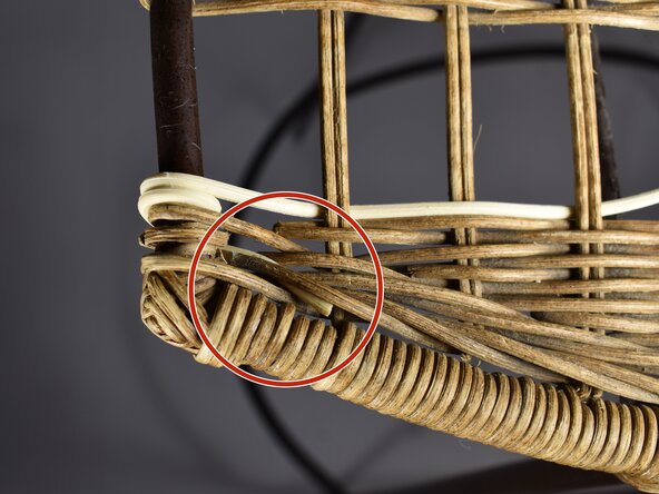

    6. How To Fix A Wicker Chair Seat: step 6, image 1 of 2 How To Fix A Wicker Chair Seat: step 6, image 2 of 2
      • Once you reach the end of the row, wrap the reed around the rail twice.
