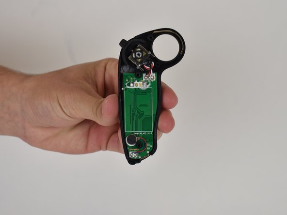

    2. Hover-1 Coast Controller Battery Replacement: step 2, image 1 of 3 Hover-1 Coast Controller Battery Replacement: step 2, image 2 of 3 Hover-1 Coast Controller Battery Replacement: step 2, image 3 of 3
      • Pull the backside of the controller off.
      • The inside of the controller should look like this.
      • The marked area is the battery.

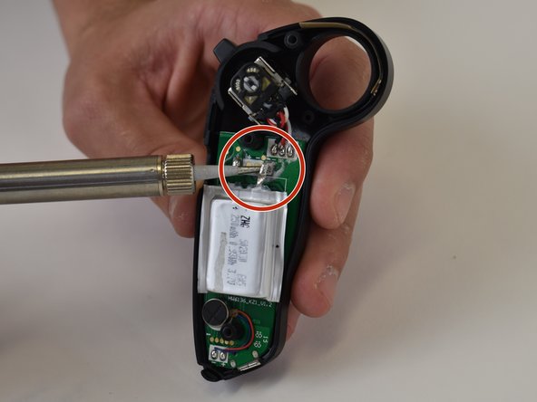

    4. Hover-1 Coast Controller Battery Replacement: step 4, image 1 of 2 Hover-1 Coast Controller Battery Replacement: step 4, image 2 of 2
      • Desolder the battery connections from the motherboard.
