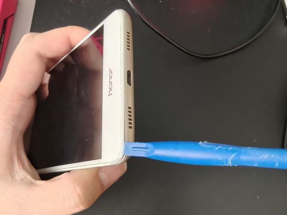

    1. Honor 6X Battery Replacement, Rear Cover Removal: step 1, image 1 of 2 Honor 6X Battery Replacement, Rear Cover Removal: step 1, image 2 of 2
      • Before opening the device, be sure to remove the SIM card tray.
      • Insert a spudger, opening pick, or any thin card into one of the four corners and slide it along the edge of the rear cover. Be careful not to insert it too deeply, as there are ribbon cables inside.
      • Do not use excessive force, as this can damage the clips and prevent the rear cover from closing properly. Additionally, the fingerprint sensor is connected to the rear cover.

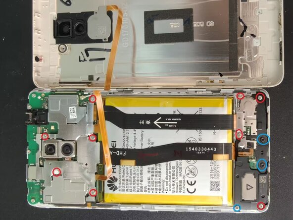

    2. Honor 6X Battery Replacement, Remove the motherboard shield: step 2, image 1 of 1
      • 10 PH0 screws (red), 2 T5 screws (blue)
      • To replace the battery, you only need to remove the top 5 screws. If the middle cable is in your way, you can choose to remove the 3 screws in the red circles on the lower right and the two screws in the blue circles.

    3. Honor 6X Battery Replacement, Disconnect the flex cable: step 3, image 1 of 1
      • The flex cable for the upper motherboard shield and the camera are adhered together; use extra care when removing it.
      • It is recommended to use a plastic tool to disconnect the flex cable from the motherboard to avoid unnecessary damage.
