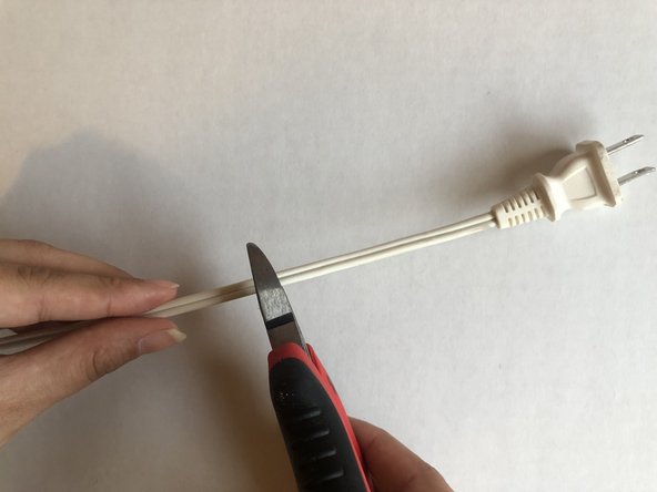

    1. Honeywell Fan  Plug Replacement, Plug: step 1, image 1 of 2 Honeywell Fan  Plug Replacement, Plug: step 1, image 2 of 2
      • Make sure to unplug the Fan.
      • Cut off the old damaged plug from the fan using a pair of wire cutters.
      Ask FixBot

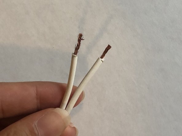

    3. Honeywell Fan  Plug Replacement: step 3, image 1 of 2 Honeywell Fan  Plug Replacement: step 3, image 2 of 2
      • Measure 3/4" inch of the wire.
      • Strip 3/4" of the insulation to expose the copper wire.
      Ask FixBot

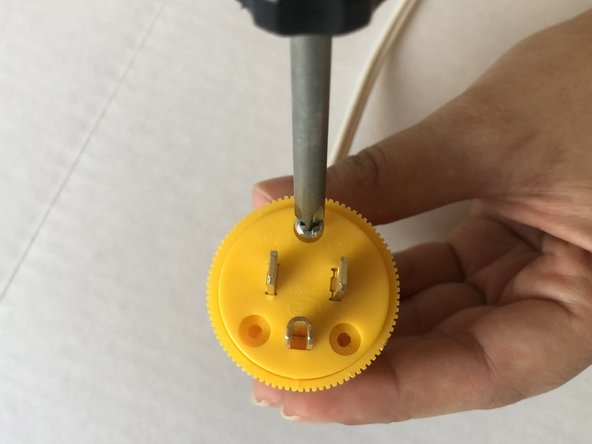

    4. Honeywell Fan  Plug Replacement: step 4, image 1 of 2 Honeywell Fan  Plug Replacement: step 4, image 2 of 2
      • Open the new plug by loosening the screws with a Phillips #0 screwdriver.
      • The silver screw is the neutral wire connection.
      • The brass screw is the hot wire connection.
      • The two different connections must be determined to wire the new plug correctly.
      Ask FixBot
    5. Honeywell Fan  Plug Replacement: step 5, image 1 of 2 Honeywell Fan  Plug Replacement: step 5, image 2 of 2
      • Twist the ends of the copper wires.
      • Twisting the wires will ensure safety while screwing the wires and reliable connection.
      • Insert the twisted wires to each of the screws.
      • The hot wire will be connected to the brass screw and has smooth insulation.
      • The neutral wire will be connected to silver screw and has small ridged insulation.

    6. Honeywell Fan  Plug Replacement: step 6, image 1 of 3 Honeywell Fan  Plug Replacement: step 6, image 2 of 3 Honeywell Fan  Plug Replacement: step 6, image 3 of 3
      • Tighten each of the screws with a Phillips #0 screwdriver.
      • Close the cover of the plug.
      • Tighten the exterior screws of the plug with a Phillips #0 screwdriver to close the plug.
