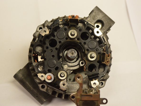

  2. Honda CSC29 Voltage Regulator Replacement: step 2, image 1 of 3 Honda CSC29 Voltage Regulator Replacement: step 2, image 2 of 3 Honda CSC29 Voltage Regulator Replacement: step 2, image 3 of 3
    • Pull cover off the body of the alternator
    • Once you have done this, you should be able to see the internal components of the alternator, particularly the bridge assembly that houses the rectifier, voltage regulator and brushes.

  6. Honda CSC29 Voltage Regulator Replacement: step 6, image 1 of 2 Honda CSC29 Voltage Regulator Replacement: step 6, image 2 of 2
    • Locate the copper leads connecting the stator to the bridge assembly. There are 3 sets of 2 leads on the perimeter of the bridge, making 6 leads total.
    • These leads must be cut in order to remove the bridge from the alternator. These leads will have to be soldered back together on reassembly. Keep the cut as clean as possible.
    • Use wire cutters to cut all 6 of the leads on the perimeter of the bridge.

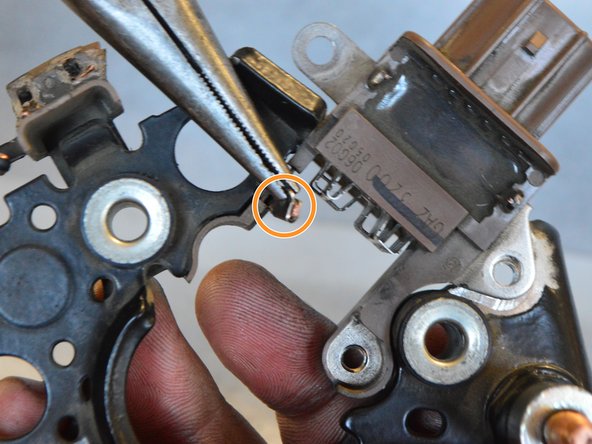

  9. Honda CSC29 Voltage Regulator Replacement, Voltage Regulator: step 9, image 1 of 2 Honda CSC29 Voltage Regulator Replacement, Voltage Regulator: step 9, image 2 of 2
    • Locate the small metal clasp attaching the voltage regulator to the the rectifier.
    • Loosen the clasp using a pair of needle-nose pliers
  10. Honda CSC29 Voltage Regulator Replacement: step 10, image 1 of 2 Honda CSC29 Voltage Regulator Replacement: step 10, image 2 of 2
    • Using a pair of wire cutters, cut the copper winding attaching the voltage regulator to the rectifier
    • Be very careful with any cuts. Keep them as clean as possible, as any severed connections will need to be soldered on reassembly.
