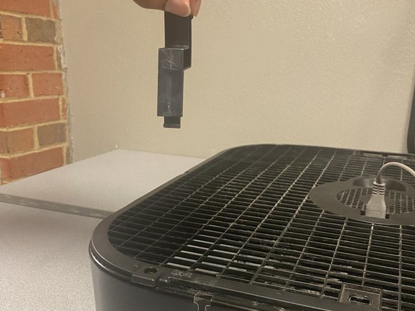

    3. Holmes Box Fan Cleaning, Removal of Stands: step 3, image 1 of 3 Holmes Box Fan Cleaning, Removal of Stands: step 3, image 2 of 3 Holmes Box Fan Cleaning, Removal of Stands: step 3, image 3 of 3
      • Lift and pull up to remove stands
      • Be careful not to break stands when removing

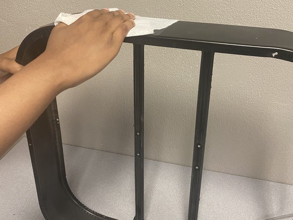

    5. Holmes Box Fan Cleaning, Removal of Main Frame: step 5, image 1 of 2 Holmes Box Fan Cleaning, Removal of Main Frame: step 5, image 2 of 2
      • Locate and remove the 4 screws on the back side of the main frame
      • Remove the main frame from the motor
      • Set screws aside so they are not lost
      • Do not damage the power cord during removal (if still attached)

    8. Holmes Box Fan Cleaning, Cleaning the Front & Back Frames: step 8, image 1 of 1
      • Clean the frames with a paper towel or cloth and then use a cotton swab to thoroughly clean the grids
      • This step may seem tedious, so patience is key
