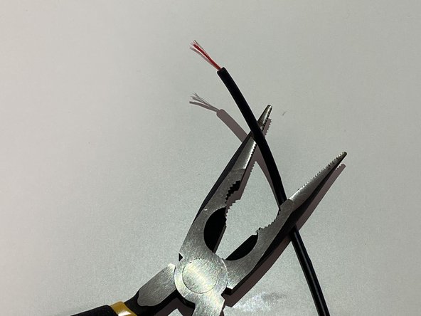

    2. Headphone Jack Replacement: step 2, image 1 of 2 Headphone Jack Replacement: step 2, image 2 of 2
      • Cut off the old faulty headphone jack.
      • Use the wire strippers to strip off the outermost rubber sheathing to expose the individual cords inside.
      • Most headphones have 3 internal wires, sometimes 4.
