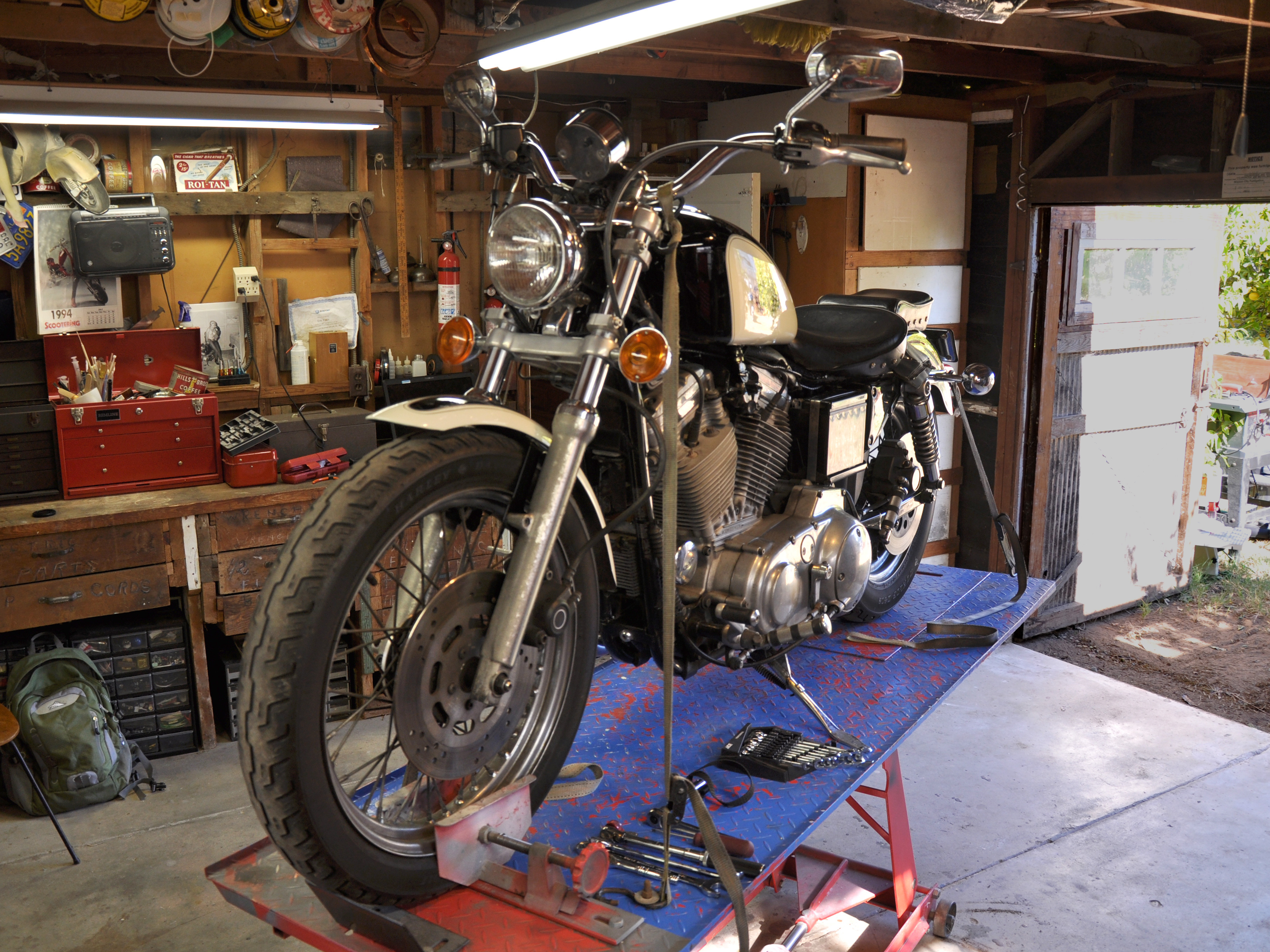

    • Securing the bike in an upright position allows for easier access to the drain tube.
    • Always make sure your work area is clean and you have plenty of room to work safely. Never start or run your motorcycle indoors.

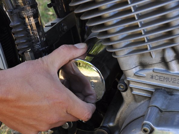

    • The oil filter is located at the front of the engine, between the frame downtube and front cylinder.
    • Move the oil pan to the front of the bike, directly underneath the oil filter.
    • Remove the oil filter. This may require an oil filter wrench.
    • If you don't have an oil-catcher, the oil will run down the frame, and get on some parts of the bike. There is no easy way to prevent this, so just wipe it down when it's done dripping.

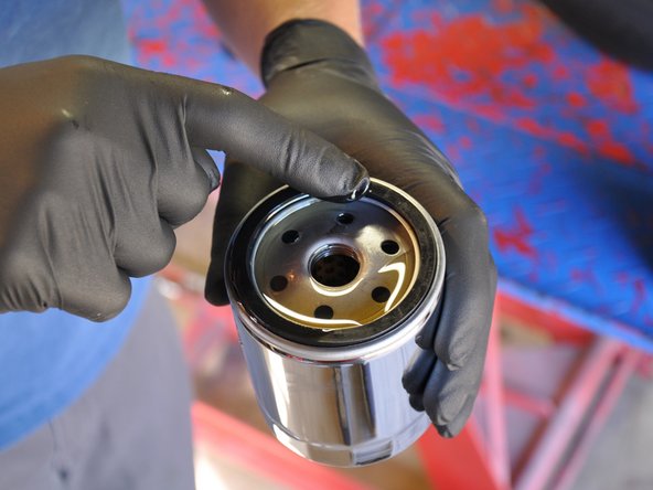

    • Open 1 quart of oil. Pour it into the filter until the filter is about 1/2 full.
    • Apply a small amount of clean oil to the rubber gasket on the new oil filter.
    • Wipe down the oil filter mounting area, and any oil residue that has run down onto the motorcycle.
    • Make sure that the old gasket came off with the filter, and you have a clean smooth surface to install the new filter on.
