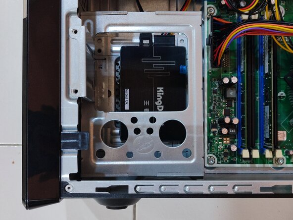

    2. Hard Drive Replacement, Remove the screws securing the hard drive bracket: step 2, image 1 of 2 Hard Drive Replacement, Remove the screws securing the hard drive bracket: step 2, image 2 of 2
      • You will need a screwdriver that fits Phillips 6-32 screws.
      • You can also try using a flat-head screwdriver of an appropriate size to remove them.

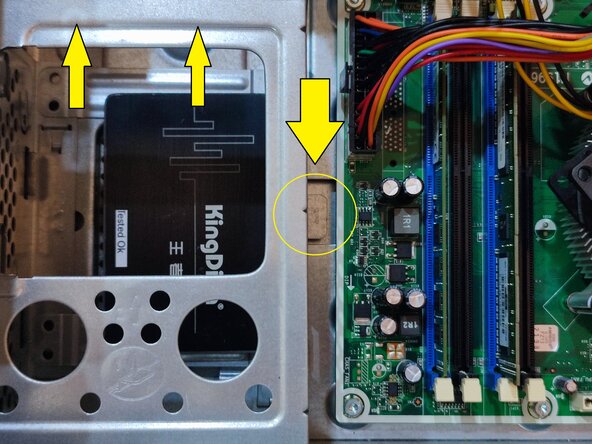

    3. Hard Drive Replacement, Remove the hard drive bracket: step 3, image 1 of 1
      • Press and hold the clip on the right side while pushing in the direction of the arrow on the left.
      • Finally, remove the four screws on the left and right sides of the hard drive bracket to remove the hard drive.
