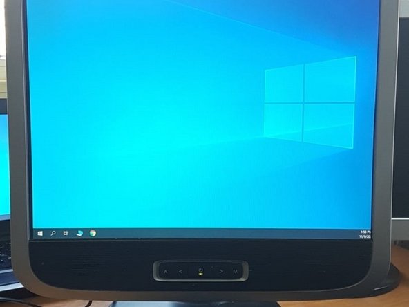

Introduction
Replacing the capacitors on the power and/or the main board may fix issues like the monitor not powering on, the screen flickering on powering etc.
Before you begin, be sure to unplug the device from the outlet.

Flip the board and inspect the capacitors. In my case they were all fine (except the one marked in blue) and the monitor was working after I changed the capacitors on the power board, but yours may be different.
After putting everything back together, the monitor was working once again. I tested both display ports and the AUX port.
If fixing the capacitors didnt resolve your problem, please leave a comment.
Thank you for following my guide and I hope it helped you!
