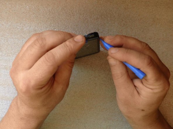

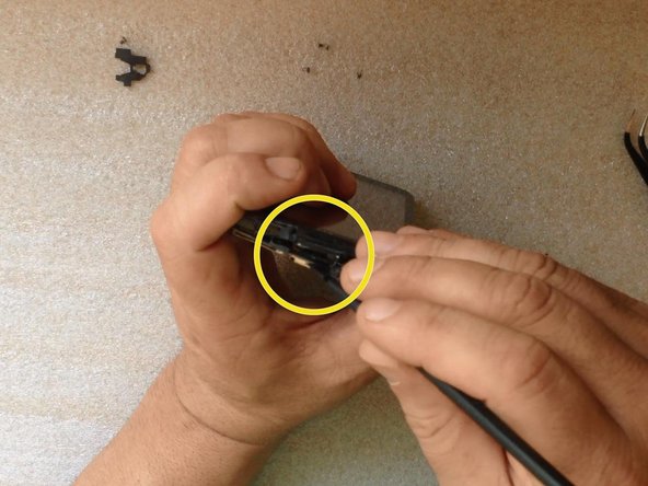

  6. HTC One X LCD Display & Touch Screen Glass Digitizer Replacement: step 6, image 1 of 3 HTC One X LCD Display & Touch Screen Glass Digitizer Replacement: step 6, image 2 of 3 HTC One X LCD Display & Touch Screen Glass Digitizer Replacement: step 6, image 3 of 3
    • At the beginning you can use a cutter to make a room for the plastic tool.
    • During the procedure of the separating the LCD Display & Touchscreen from the frame, you can use again hot air. This will make separating more easy.

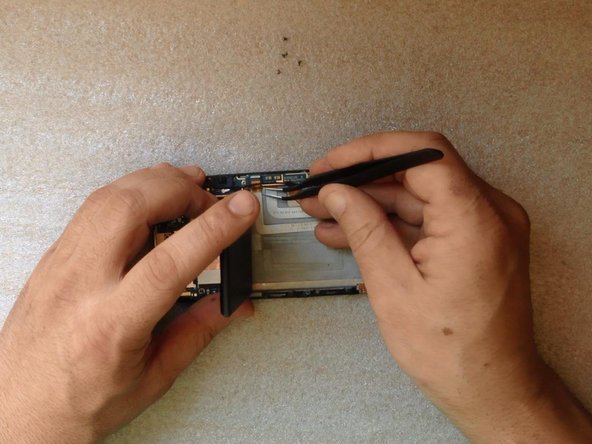

  7. HTC One X LCD Display & Touch Screen Glass Digitizer Replacement: step 7, image 1 of 3 HTC One X LCD Display & Touch Screen Glass Digitizer Replacement: step 7, image 2 of 3 HTC One X LCD Display & Touch Screen Glass Digitizer Replacement: step 7, image 3 of 3
    • The original adhesive tape is left on the frame, but I prefer to put new. I put it onto the original.
    • Gently assemble the screen to the frame.
