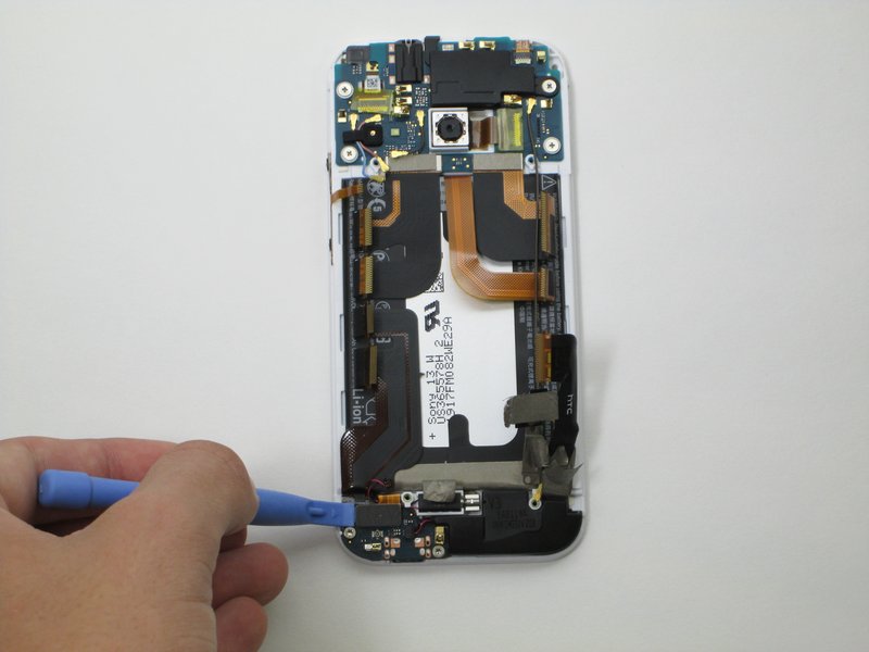

    1. HTC One Mini 2 Charging Port Replacement, Charging Port: step 13, image 1 of 1
      • Use the narrow plastic tool to pry up the black foam covered rectangular connector.
      Ask FixBot
