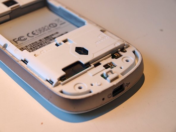

A part that might fail after you drop your HTC Magic is the speaker. Here's how to replace it. You will need Torx T6 & T5 drivers , a screwdriver, & a iPod opening tool(s).
Tools
    1. HTC Magic Speaker Replacement, Speaker: step 1, image 1 of 3 HTC Magic Speaker Replacement, Speaker: step 1, image 2 of 3 HTC Magic Speaker Replacement, Speaker: step 1, image 3 of 3
      • Open the phone by removing it's backcover (battery door) and the battery.
      • REMEMBER to remove the simcard and microSD card. If you do not they'll be damaged when you remove them at a later stage.
