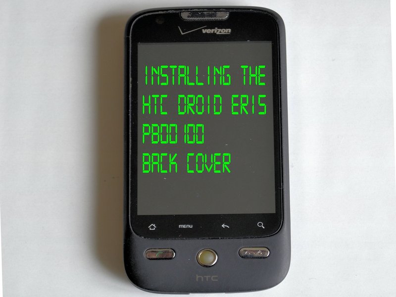

This guide will teach you how to replace/install the midframe of your HTC Droid Eris phone.
