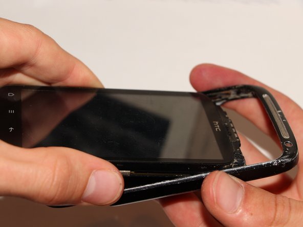

    4. HTC Desire S Disassembly: step 4, image 1 of 3 HTC Desire S Disassembly: step 4, image 2 of 3 HTC Desire S Disassembly: step 4, image 3 of 3
      • To open the top cover, you'll need a guitar pick or a small knife. The cover is pinned and lightly glued, so be careful not to break the small plastic tabs. Cut any glue strands that form when prying it off.
      • Starting at the top corner, carefully pry off the cover and continue along the top edge.
      • Once the top part of the cover is detached from the aluminum frame, you can carefully pull the cover upwards.

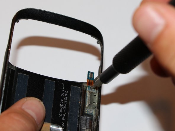

      • First you need the aluminum frame.
      • Use a Torx T5 screwdriver to remove the two screws from the micro-USB port. You can then remove the port.

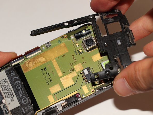

    10. HTC Desire S Disassembly: step 10, image 1 of 2 HTC Desire S Disassembly: step 10, image 2 of 2
      • Remove the two Torx T5 screws with a screwdriver.
      Ask FixBot
    11. HTC Desire S Disassembly: step 11, image 1 of 3 HTC Desire S Disassembly: step 11, image 2 of 3 HTC Desire S Disassembly: step 11, image 3 of 3
      • Use a knife or a pick to remove the glued volume buttons from the top plastic frame.
      • Now you can lift off this plastic frame.

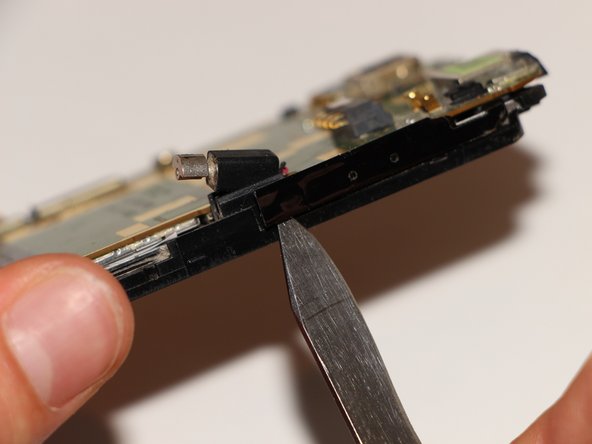

    12. HTC Desire S Disassembly: step 12, image 1 of 3 HTC Desire S Disassembly: step 12, image 2 of 3 HTC Desire S Disassembly: step 12, image 3 of 3
      • What would HTC be without a lot of adhesive? You can remove the glued-on film at the bottom with a knife or a pick.
      • Once you have loosened the film at one corner, you can slowly peel it off by hand.

    13. HTC Desire S Disassembly: step 13, image 1 of 2 HTC Desire S Disassembly: step 13, image 2 of 2
      • Carefully remove the vibration motor on the right side.
      • Also remove the glued volume buttons from the bottom edge.

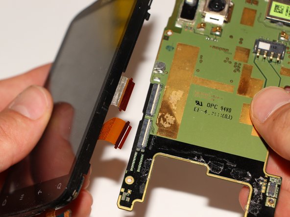

    16. HTC Desire S Disassembly: step 16, image 1 of 3 HTC Desire S Disassembly: step 16, image 2 of 3 HTC Desire S Disassembly: step 16, image 3 of 3
      • Turn the smartphone over. Use a knife or tweezers to carefully peel off the adhesive strip.
      • Now open the plastic clips of the two connectors and separate the main board from the display unit.

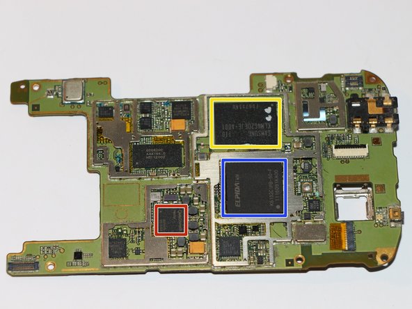

    21. HTC Desire S Disassembly: step 21, image 1 of 2 HTC Desire S Disassembly: step 21, image 2 of 2
      • This is what the circuit board finally looks like. I was only able to identify three chips.
      • red - processor (Qualcomm Snapdragon MSM8255)
      • blue - RAM (Elpida TWN K6132C1PB-50-F)
      • yellow - internal memory (Samsung KLM4G2DEJE-A001)
      • I would be very grateful for further information on the other chips. Just leave a comment if you have any expertise in this area.

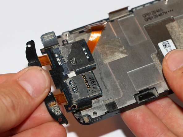

    23. HTC Desire S Disassembly: step 23, image 1 of 3 HTC Desire S Disassembly: step 23, image 2 of 3 HTC Desire S Disassembly: step 23, image 3 of 3
      • Slowly and very carefully pull the glued flex cable off the display unit.
      • Now, using a knife or a pick, slide under the edges of the SIM and micro SD card holder. This is also glued in place, so slowly work from the edges toward the center and carefully pry it off.
