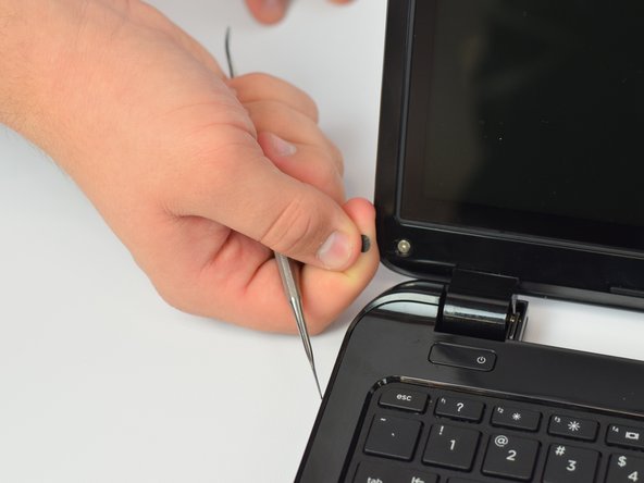

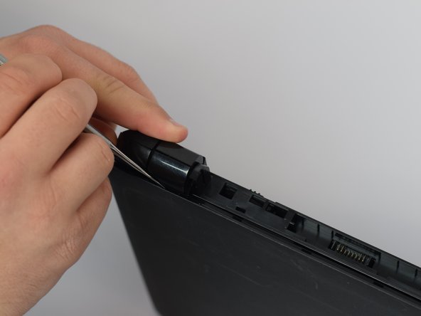

  3. HP TouchSmart 15-r015dx Screen Replacement: step 3, image 1 of 3 HP TouchSmart 15-r015dx Screen Replacement: step 3, image 2 of 3 HP TouchSmart 15-r015dx Screen Replacement: step 3, image 3 of 3
    • Take the sharp end of the pry tool and pop out the black screw cover.
    • Repeat on opposite side.

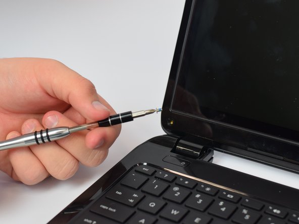

  4. HP TouchSmart 15-r015dx Screen Replacement: step 4, image 1 of 3 HP TouchSmart 15-r015dx Screen Replacement: step 4, image 2 of 3 HP TouchSmart 15-r015dx Screen Replacement: step 4, image 3 of 3
    • Take the Precision Magnetized Driver with J1 size bit and unscrew the screw.

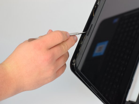

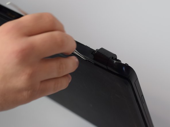

  5. HP TouchSmart 15-r015dx Screen Replacement: step 5, image 1 of 3 HP TouchSmart 15-r015dx Screen Replacement: step 5, image 2 of 3 HP TouchSmart 15-r015dx Screen Replacement: step 5, image 3 of 3
    • Using the pry tool, begin to separate the touchscreen from the plastic backing.

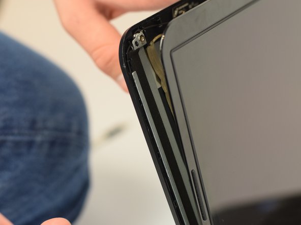

  6. HP TouchSmart 15-r015dx Screen Replacement: step 6, image 1 of 3 HP TouchSmart 15-r015dx Screen Replacement: step 6, image 2 of 3 HP TouchSmart 15-r015dx Screen Replacement: step 6, image 3 of 3
    • Close the laptop and flip it over once again.
    • Continue to pry the touchscreen from the plastic backing in the hinged area of the laptop.

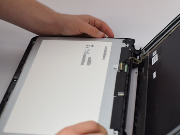

  7. HP TouchSmart 15-r015dx Screen Replacement: step 7, image 1 of 3 HP TouchSmart 15-r015dx Screen Replacement: step 7, image 2 of 3 HP TouchSmart 15-r015dx Screen Replacement: step 7, image 3 of 3
    • Flip over the laptop and open it.
    • Pull up on the separated touchscreen while pulling it away from the plastic backing.
    • Be careful while laying down the touchscreen to not pull the connection point.
    • Lay the touchscreen on the keyboard facedown.

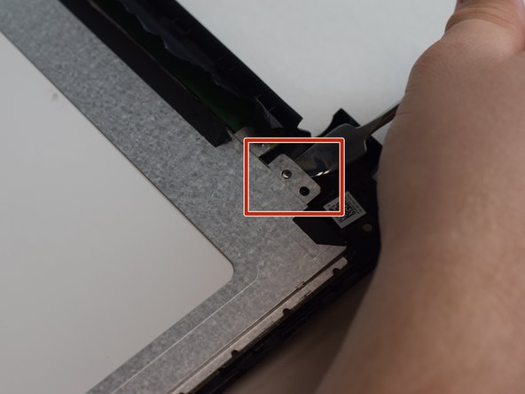

  8. HP TouchSmart 15-r015dx Screen Replacement: step 8, image 1 of 3 HP TouchSmart 15-r015dx Screen Replacement: step 8, image 2 of 3 HP TouchSmart 15-r015dx Screen Replacement: step 8, image 3 of 3
    • Locate the connection point.
    • Slowly and carefully peel off.

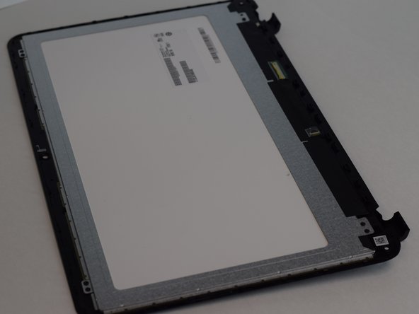

  9. HP TouchSmart 15-r015dx Screen Replacement: step 9, image 1 of 2 HP TouchSmart 15-r015dx Screen Replacement: step 9, image 2 of 2
    • Isolate the touchscreen from the keyboard.

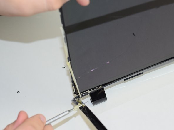

  10. HP TouchSmart 15-r015dx Screen Replacement: step 10, image 1 of 3 HP TouchSmart 15-r015dx Screen Replacement: step 10, image 2 of 3 HP TouchSmart 15-r015dx Screen Replacement: step 10, image 3 of 3
    • Begin by peeling off the black adhesive tape using the pry tool.
    • Once adhesive tape is removed, use the pry tool to remove the tab in the corner. Repeat in each corner.

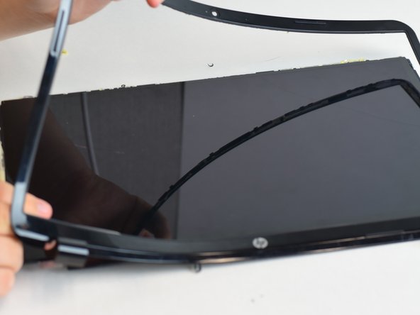

  11. HP TouchSmart 15-r015dx Screen Replacement: step 11, image 1 of 3 HP TouchSmart 15-r015dx Screen Replacement: step 11, image 2 of 3 HP TouchSmart 15-r015dx Screen Replacement: step 11, image 3 of 3
    • Using the sharp end of the pry tool, separate the plastic from the screen.
