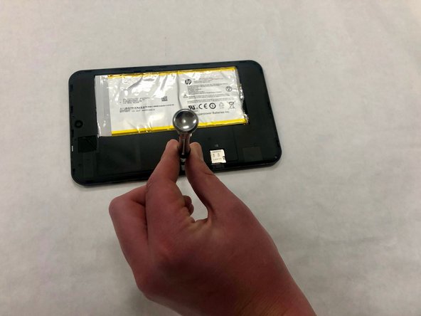

The guide details how to replace the display panel cable. The cable is important for the communication throughout the HP Stream 8.
Tools
    1. HP Stream 8 Display Panel Cable Replacement, Display Panel Cable: step 1, image 1 of 1
      • Use your nail to pry up the back cover of the device.
      Ask FixBot
    2. HP Stream 8 Display Panel Cable Replacement: step 2, image 1 of 1
      • Fully remove the back cover.
      Ask FixBot
    3. HP Stream 8 Display Panel Cable Replacement: step 3, image 1 of 3 HP Stream 8 Display Panel Cable Replacement: step 3, image 2 of 3 HP Stream 8 Display Panel Cable Replacement: step 3, image 3 of 3
      • Remove the 10 3mm screws using the Phillips #00 screwdriver.
      Ask FixBot
    4. HP Stream 8 Display Panel Cable Replacement: step 4, image 1 of 2 HP Stream 8 Display Panel Cable Replacement: step 4, image 2 of 2
      • Pry up the inside cover the same way as you did with the back cover.
      Ask FixBot
    5. HP Stream 8 Display Panel Cable Replacement: step 5, image 1 of 1
      • Remove the USB flex ribbon cable from the connection point.
      Ask FixBot
    6. HP Stream 8 Display Panel Cable Replacement: step 6, image 1 of 2 HP Stream 8 Display Panel Cable Replacement: step 6, image 2 of 2
      • Carefully disconnect the display panel cable from the system board.
      Ask FixBot
    7. HP Stream 8 Display Panel Cable Replacement: step 7, image 1 of 1
      • Remove the display panel cable.
      Ask FixBot
