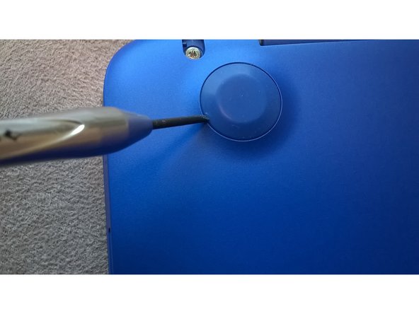

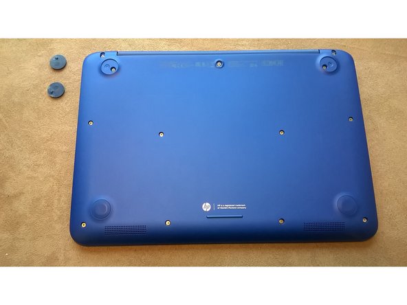

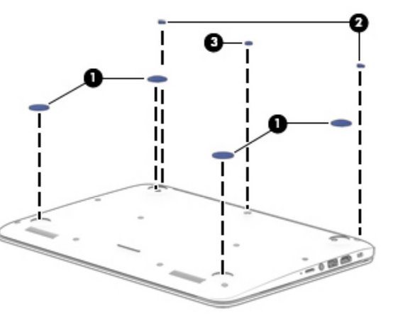

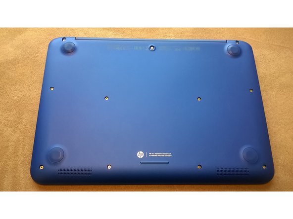

  2. Flip your laptop over. There are four pads that you need to remove to access the screws. Remove the center pad first as shown in the picture. Flip your laptop over. There are four pads that you need to remove to access the screws. Remove the center pad first as shown in the picture.
    • Flip your laptop over. There are four pads that you need to remove to access the screws. Remove the center pad first as shown in the picture.
  3. Beneath each pad is a screw. Make sure you remove all of the pads. Beneath each pad is a screw. Make sure you remove all of the pads. Beneath each pad is a screw. Make sure you remove all of the pads.
    • Beneath each pad is a screw. Make sure you remove all of the pads.

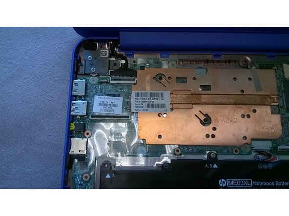

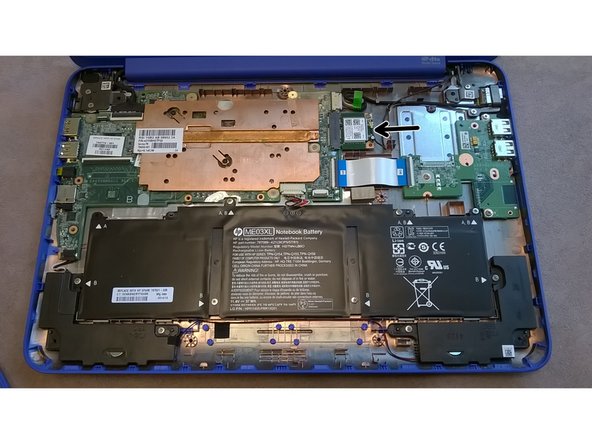

  6. The  WiFi/Bluetooth mPCIe card is located to the right of the  motherboard, highlighted with the arrow.
    • The WiFi/Bluetooth mPCIe card is located to the right of the motherboard, highlighted with the arrow.
  7. You'll notice that there is a large gap for the WWAN card and no M.2 connection. It is possible to extend the mPCIe card and remove the WiFi card completely. Another option might be to purchase a board with an M.2 WWAN card and swap it out with an SSD. Unfortunately these are quite rare. You'll notice that there is a large gap for the WWAN card and no M.2 connection. It is possible to extend the mPCIe card and remove the WiFi card completely. Another option might be to purchase a board with an M.2 WWAN card and swap it out with an SSD. Unfortunately these are quite rare.
    • You'll notice that there is a large gap for the WWAN card and no M.2 connection. It is possible to extend the mPCIe card and remove the WiFi card completely. Another option might be to purchase a board with an M.2 WWAN card and swap it out with an SSD. Unfortunately these are quite rare.

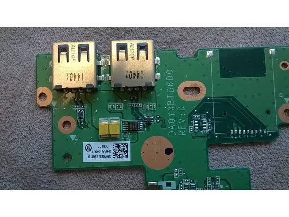

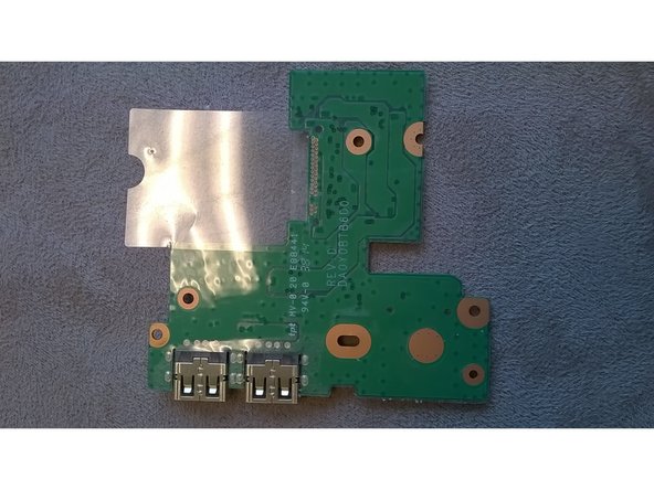

  8. A close up of the USB WWAN Board. A close up of the USB WWAN Board. A close up of the USB WWAN Board.
    • A close up of the USB WWAN Board.
  9. As stated before, you can swap this card out with a half-width PCIe SSD found on Amazon or other electronics retailers. As stated before, you can swap this card out with a half-width PCIe SSD found on Amazon or other electronics retailers.
    • As stated before, you can swap this card out with a half-width PCIe SSD found on Amazon or other electronics retailers.

Make sure that you order an *PCIe* mini half-width or full-width (buy or make an extension bracket) and you have the current BIOS (HP sometimes whitelists cards).
Be forewarned- Not all mSATA cards will play nice with this slot. I personally recommend the Samsung PM830 128GB SSD HDD Mini PCIe from Amazon for only $40. Word of wisdom, you may have to reconnect the battery for Windows to recognize it.
