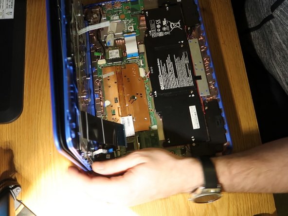

    5. HP Stream 13 Battery Replacement: step 5, image 1 of 2 HP Stream 13 Battery Replacement: step 5, image 2 of 2
      • Disconnect the battery from the main board.
      • Unscrew the 8 screws holding the battery in place.
